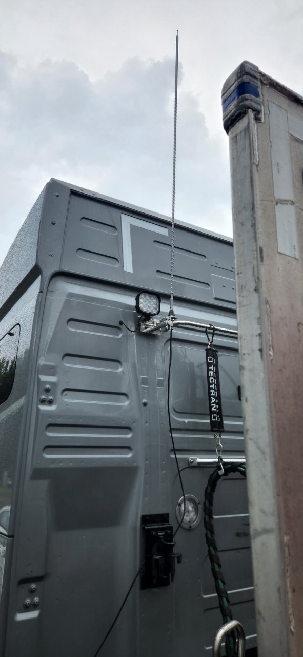

    As far as bonding I think you'll find the Volvo to be much easier to deal with than the Cascadia. Volvos are made of steel and the cab/sleeper body panels are welded together unlike the Cascadia being aluminum and "glued" together. I basically mounted my antenna and got good readings on the analyzer without any ground straps, unlike the Cascadia! I have my antenna mounted on the back of the sleeper on a bird perch mount from Bob's CB. Top Gun Technologies (Z-PERCH) - Ultra Mount with Heavy Duty Bird Perch, For SOME Volvo's / Freightliner Cascadia's / Kenworth T2000's / & Peterbilt 579's, ALL STAINLESS STEEL, Mobile Antenna Mounts Mounts using the factory bolts for the hook up light and the top bar for the trailer lines. 20220904_160319.jpg Alas this probably won't be ideal for you as, last I knew, you were pulling a dry van/reefer. That mount can work on the rearward mirror bracket, but will take a little fiddling to make it sturdy. Either mounting point will limit you to a 5 foot Skipshooter. Mine will hit a 13'5" bridge. The other alternative is the standard bird perch mount. They do tend to be a little on the thin side so finding a mount that will tighten up right can be tricky.

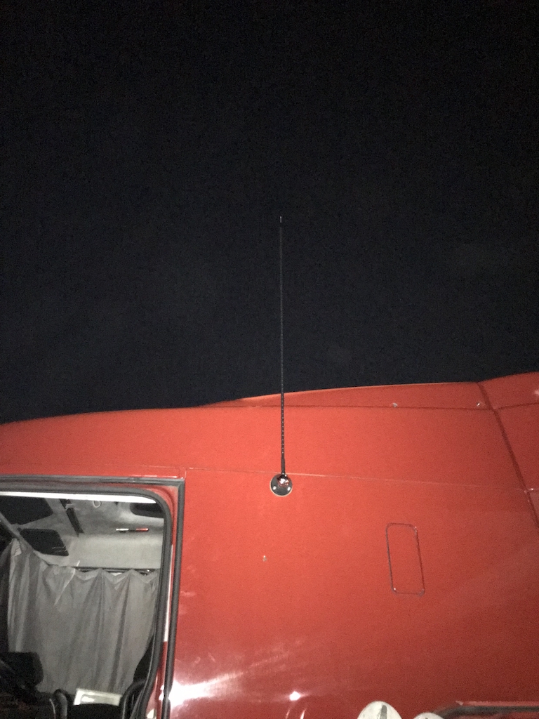

    I mounted mine here on my old 610. It needs bonding. Figured being a 98 and metal it would have been better. It's under 2:1 in the middle of the band, but I need to do some bonding. The readings with the Rig Expert weren't too good. I'll get to it sooner or later. I think that is a 5' SkipShooter on it. I've got a 4ft and don't remember which one I put on it.
