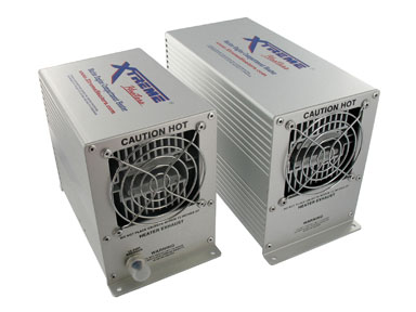

    As to your comment on running my system in newer trucks I got my idea from the PonyPack APU. I just modified the idea to include an electric compressor and the electric fans on the truck condensor.
    Heat Issue is taken care of with a PTC radiant heater. This idea came from koolrig.
    2 of the 300 watt units would thouroughly heat a 72" condo and cab
