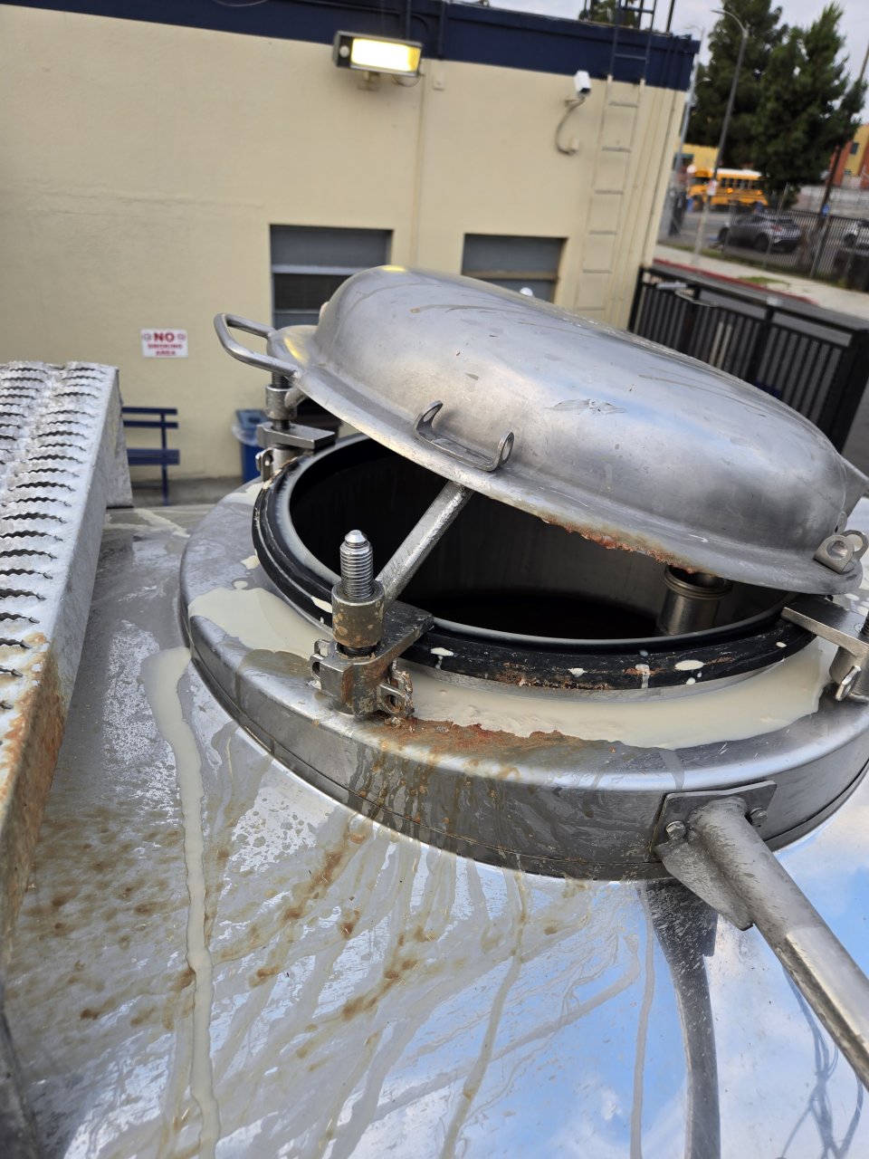

    Just had to cut the seal and vent the tank on my current load so figured a picture would be good.
    As you can see, even with me tightening the dome as much as possible there can still be some seepage as the liquid sloshes around. Most of that leaked out after I opened the dome though.

  9. nextgentrucker
    nextgentrucker Road Train Member
    1,702
    1,622
    Sep 25, 2023
    Port Saint Lucie, Fl
    Ok, cool, what were you hauling btw, looks like chocolate.
