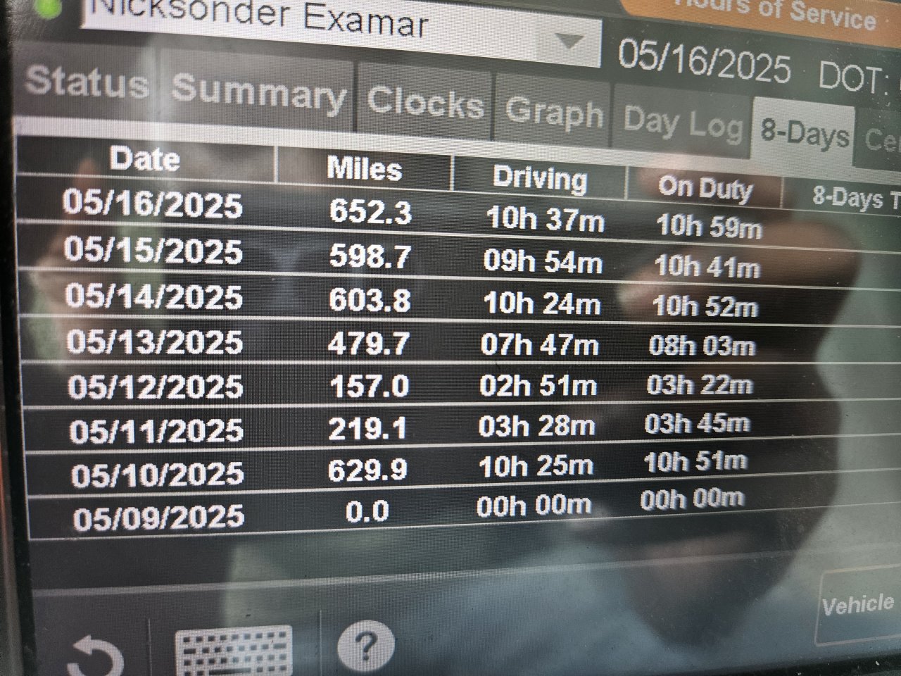

    Yes I run my clock down. I ran it down a week ago all the way to 30 minutes left on my 70 and I picked up 9 1/2 the next morning… You need to look at your logs through your recap and look at your last eight days The furthest day out is what you’re gonna be picking up the following day when you’re running recaps

    Ok, I'm finally gonna do a 34, I could make it to the plant tomorrow, drop the tank then head to the yard but I look at my recap and I'm only getting about 3hrs and a half for both Monday and Tuesday. I'm going home this week so I don't want take a chance with these hours lol, so a 34 it is, it's a drop and hook anyway plus I talked to dispatch and he said I don't have any pre-planned behind me so I should be uu good.

    It doesn’t make as much sense to you, probably because you entered the industry in the post-paper log era. Most of us on here had to physically write out our previous days in preprinted boxes on a paper log and use a calculator to find our available hours on a daily basis at one point in time. I’m going to take a shot at explaining it to help you understand better. If anyone wants to correct me or chime in, feel free to.
    You have a 70 hour clock. The hours you work today, along with the hours you’ve worked in the previous seven days can’t exceed the number 70. So, hypothetically speaking, if your previous seven days total up to 65 hours when you add them together, that means you can only work a total of five hours today. Eight days are factored into the math, and today counts as one of those eight days.
    Why do you gain time back at midnight? Because every night at midnight, that eighth day drops out of the equation. It doesn’t get counted anymore. The day you had been referring to as #7 now becomes #8 as if it were playing musical chairs. The “musical chairs” take place every night at midnight, and the math has to be recalculated. Just remember it this way, the previous seven days subtracted from 70 is what you have available today.
    Your electronic log does the math for you. It tells you on the right side of the screen “Hours to be gained” (referring to tonight) and “Hours to be gained in 2 days” (referring to tomorrow night) as a convenience feature to help you trip plan and enable you to forecast what you are capable of doing over the next few days.
    When drivers make the statement “I’m running off recap,” they are basically just saying that they’re doing what they can, and everyday isn’t a guaranteed 14 hour clock. They are continuing to operate based on what they gain back each night at midnight when that eight day drops out of the math equation like I explained above.
