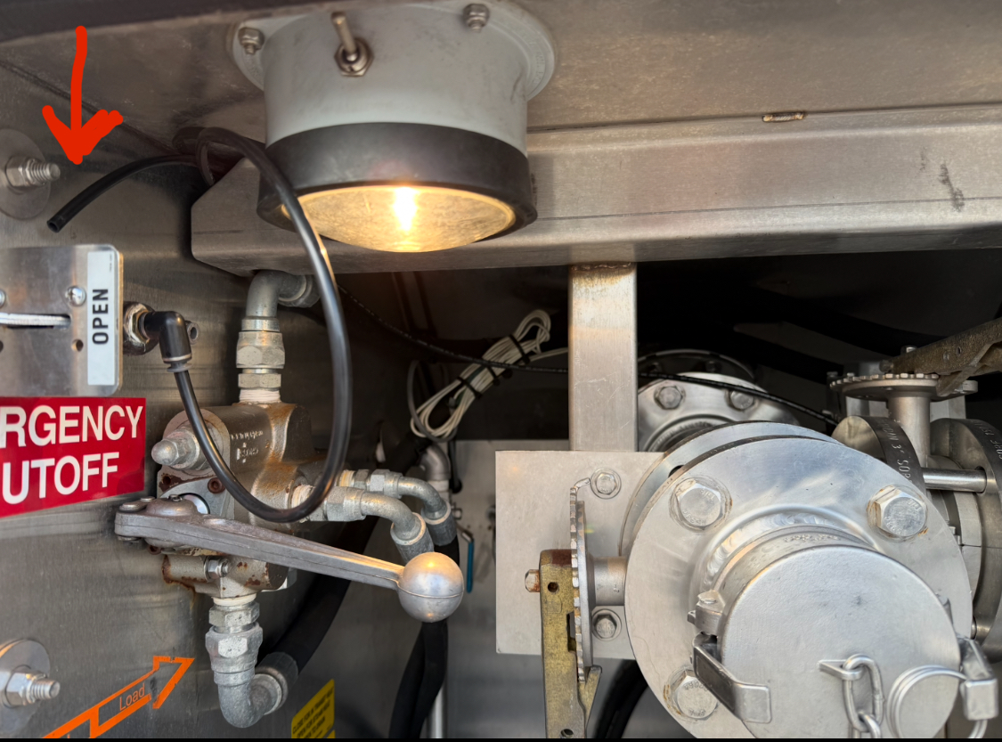

    IMG_1823.jpeg @Cobrawastaken
    I need to tap into your pump truck experience in case I encounter this in the future. I picked up an empty whiskey tank in Bradenton, FL this evening. I pushed my trailer knob in to air up the bags while I was doing my walk around. When I got back in the truck, I noticed it was taking longer than normal to build up air. So, I got out again to make sure the airbags were ok. I heard an air blower-like sound coming from inside the rear box. Since it was empty and I’m just taking it to the terminal, I cut the seal on the back to open the doors and have a look. Air was coming out of this black hose below the arrow in the picture. (top left, looks like it belongs on the valve below it) I traced it backwards with my hand, thinking it would lead to a valve, but I didn’t feel comfortable messing with anything. I decided to leave it alone to prevent any of the plumbing from accidentally becoming pressurized. What are your thoughts?

    Never seen a hose loose like that. I bet that loose end connects to the internal tank valve. Some whiskey tanks need air supplied to the trailer to keep that internal valve open.

    I believe @Redtwin is correct about that. Looks like it's for the internal valve in the tank. That would probably need to be fixed ASAP since the valve might not work and the trailer wouldn't be able to be loaded/unloaded without being able to open the internal valve. I've also never seen an IRT trailer with that setup from what I can remember but I don't know... maybe I have once or twice. It's been a while though.

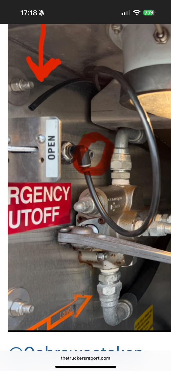

    IMG_8607.jpeg Looks like it possibly popped off of that piece in the back. Looks like an air actuated line for an internal switch maybe.
