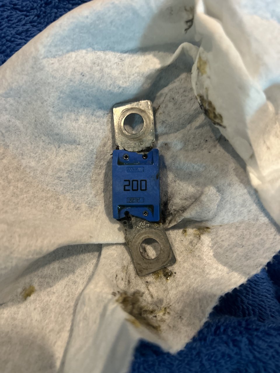

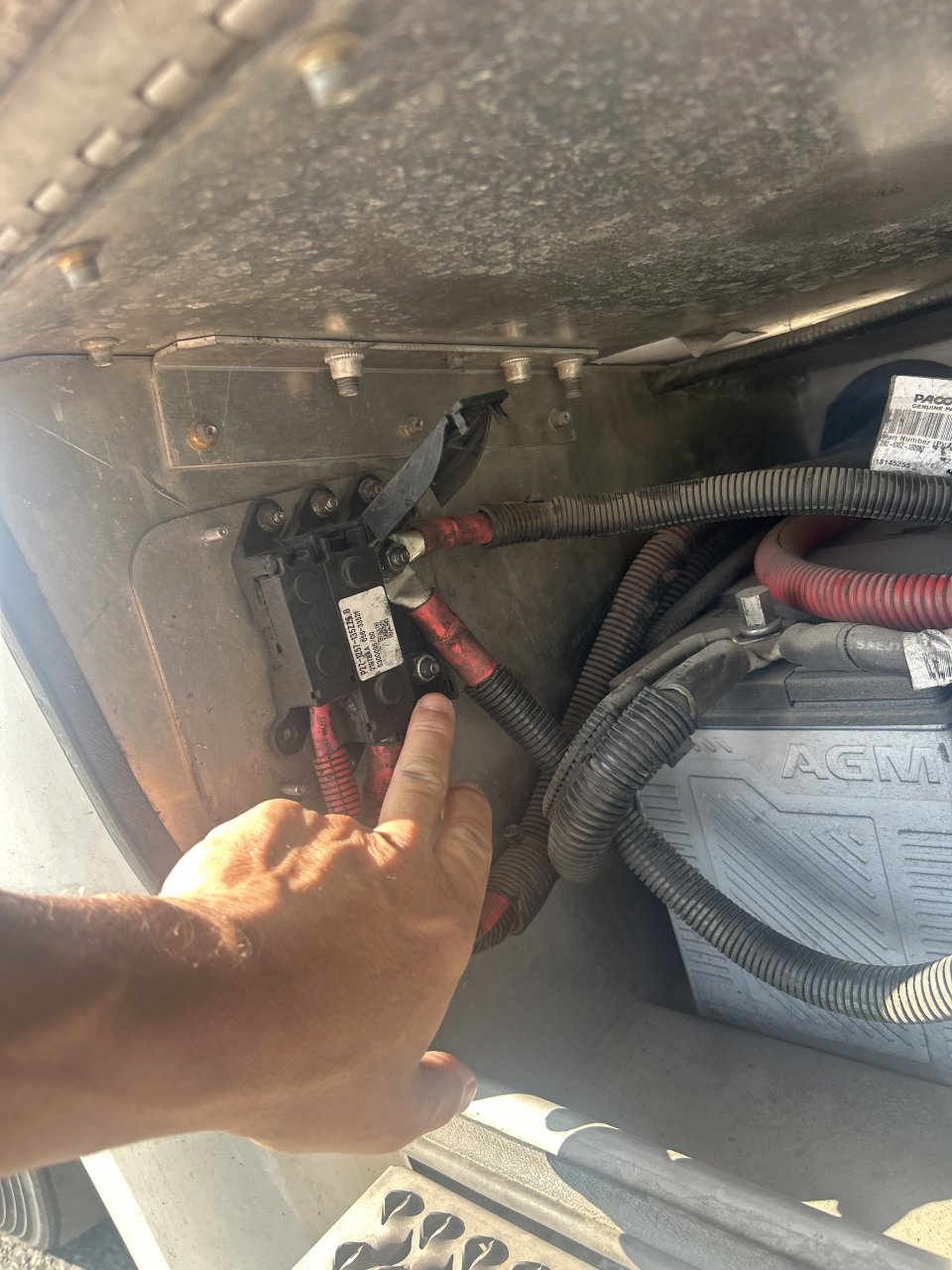

    If your inverter beeps once in a while when you’re making coffee or using the microwave, you might check the battery terminal nuts. They had a tendency to loosen up in my previous truck.
    Friend, nextgentrucker and trimetro Thank this.

    I am positive they are not letting us get any work done at loves unless it is absolutely necessary. Best bet is get to Winter Haven and write it up. Another tip if the inverter voltage seems to be dropping but the truck voltage stays good my bet would be the 200amp fuse is bad it seems to brake one half of the fuse from vibration inverter will work until you put a big load on it like a coffee maker or air fryer.
    Friend, Redtwin and trimetro Thank this.
