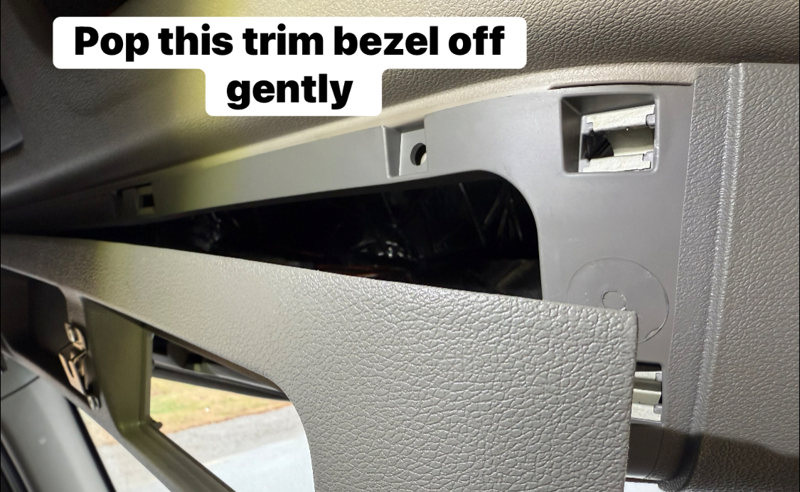

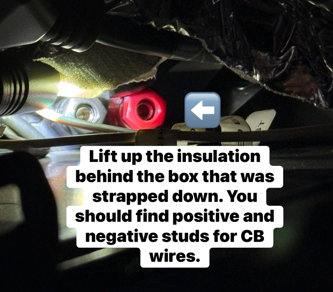

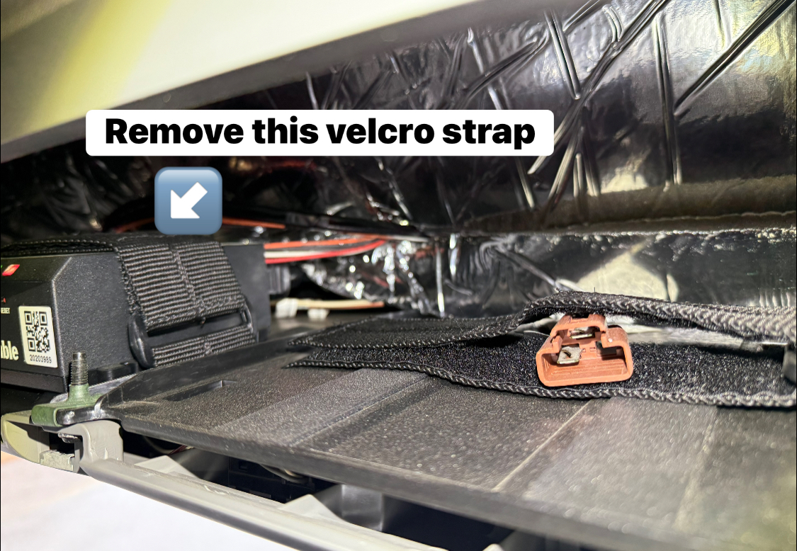

    Don’t see any power connection for the CB. Driving me nuts without a radio….only speaker and antenna connections.

    I’m not sure what type of truck you were issued, but this is where the connections are in the Peterbilts we have.
