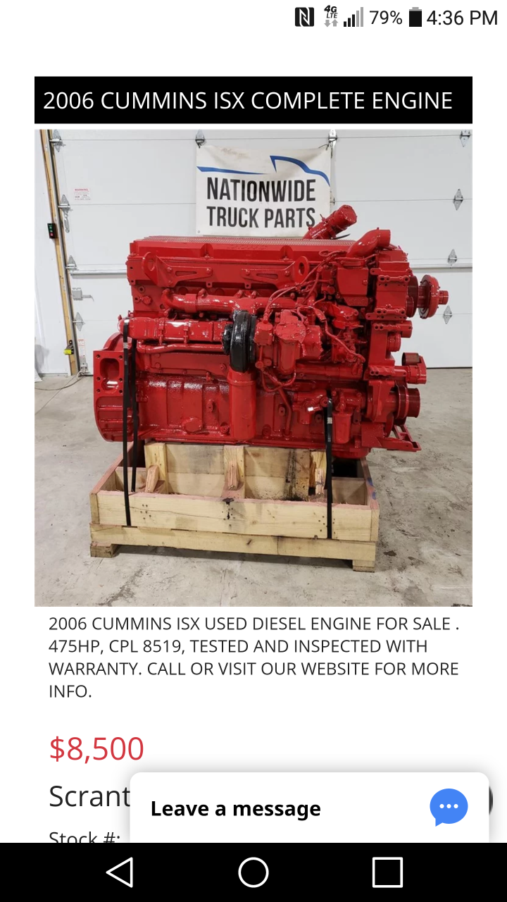

    This is what made me think it would be easier to just drop a motor in it rather than inframe it. From the sounds of it, its not as simple as it would seem!?

  9. 062
    062 Road Train Member
    6,352
    34,034
    Oct 20, 2013
    That’s a pull out. All they know about it is that it runs.

    That looks tempting. The $20 worth of paint really makes it look good. If you knew it had a recent OH, not bad. But for $7-10 k more, You’ll have a new engine. The labor spent on installing a used engine is a waste of money. Unless it’s the only choice, because of lack of funds. It will still cost more in the next 3-5 yrs. If not much sooner.

    I see where it says "with warranty"....I wonder what that covers!
