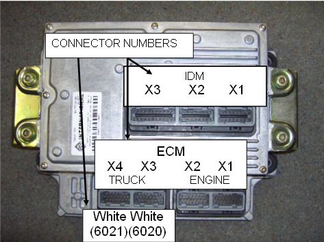

    If your ok with diagrams you could do check for opens or shorts. This will be X2 of the IDM. If your ECM/IDM looks different, let me know what year your truck is and I will try again.
    [SIZE=+1]Injector Cylinder 4 [/SIZE] Test Point
    X2-1 to X2-21 spec 0.7 Ω to 1.5 Ω
    If > 1.5 Ω, check for open or high resistance between IDM and injector, or open injector coil
    X2-1 to gnd, X2-21 to gnd spec > 1 kΩ
    If < 1 k&#8486;, check for short to ground in harness or injector coil. Disconnect injector and retest. If > 1 k&#8486;, the short is in the injector.
    X2-5 to X2-22 spec 0.7 &#8486; to 1.5 &#8486;
    If > 1.5 &#8486;, check for open or high resistance between IDM and injector, or open injector coil
    X2-5 to gnd, X2-22 to gnd spec > 1 k&#8486;

    Thanks for the shcematic flow, i used it and it ended up being that the #4 and also #1 injector were gone bad. Used pro-link from snap did an injector load test and now all injectors spread out on the engine load percentage. Thanks, for you're help
