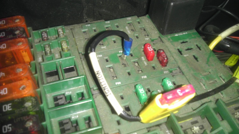

    Here is a picture of how it would connect to the battery box. Well sort of as this picture is just feeding off the positive side. But it does show the inline fuse and how it is pluged into the fuse box. You would acualy have two wires going to the fuse box. One in each slot.

    Ruges,
    Wow. Thanks for being so detailed!
    My problem is still the male connectors. I've been to several Radio Shacks, auto parts stores, and even called specialty electronics and custom car shops trying to find the right male blade connector. The smallest I have been able to find is 3/16, Radio Shack part number 64033132. These are too big. Only thing I can think to do it's manually trim the male piece itself with a Dremmel or something.
    Can you tell me which size you are using in your picture?
