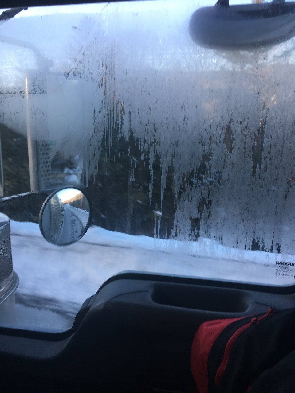

Inside of driver window freezing tip.
Discussion in 'Experienced Truckers' Advice' started by Short Fuse EOD, Dec 29, 2017.

    I’ve always found that recirculate produces more fog and frost.

    I guess it depends on where the outside humidity is in comparison to current interior levels. But if your interior is getting humid, it's probably fairly moist outside.

    Of the few good things about the Freightliner I drive windows never frost up. I keep heat at about half and fan at #4 in -40c temps. Only ever been a issue in leaky trucks. Humidity definitely plays into the frost

    Do you have anything on the floorboard of the passenger side? I used to keep a trash can over there asks it would cause the passenger side to freeze over. Moved it and problem solved

    My truck does that whens it's below -20c. Apparently Pete never thought tgat having warm air on the windshield and the side windows at the same time was necessary :( . l hung an old fashioned fan up in the centre of the windshield and it moves the warm air around enough to fix it mostly.

    Hvac setting to fresh air with ac and defroster on high should handle anything IF the hvac system is operating correctly/efficiently.
