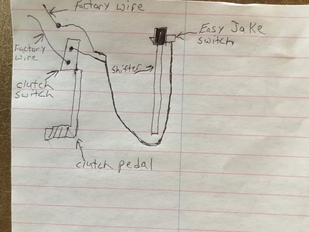

2013 Freightliner Cascadia - 3 Wires, Red, Green and Black. I cut the Green Wire (middle), spliced it to the 2 wires for the Easy Jake. While it's not a perfect fix, it does interrupt the cruise control and jake brake. As an example, I had cruise control set, jake brake on. I flip the switch, cruise disengages, flip the switch back and the jake comes on. This allows me to use the jake periodically while in traffic. Hope this helps.
Do you have schematic of some sort showing exactly how you wired this? Having a hard time understanding if you spliced any wires or just tapped in to the wires. Thanks
Here’s a picture of a very rough diagram to help you understand.
It basically puts the easy Jake switch in series circuit with the clutch switch.
