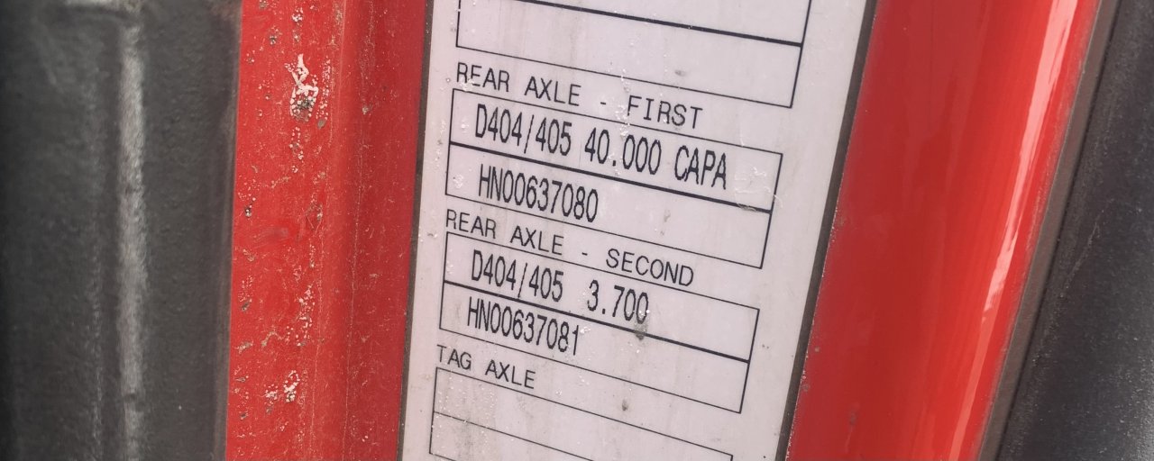

  8. bwill092
    bwill092 Bobtail Member
    11
    2
    Mar 14, 2020
    This is what my rating says. What does it mean? In terms of torque ability.
  9. Socal Xpress
    Socal Xpress Road Train Member
    1,855
    1,958
    Dec 6, 2014
    Los Angeles, Ca
    That's the rear end ratio 3.70.
  10. bwill092
    11
    2
    Mar 14, 2020
    So pulling heavy loads(45k)on hills shouldn’t be that big a issue? My problem is even on the slightest hill, my truck loses so much power. Rpm drops significantly and my speed drops to 40 to 50mph
  11. Brettj3876
    Brettj3876 Road Train Member
    11,257
    54,060
    Nov 18, 2014
    Land of local
    3.70 is an all around great ratio for running in the mountains. Your 385 hp is the issue. Give those guys a call on that website i linked. That tune will pay for itself in fuel savings
