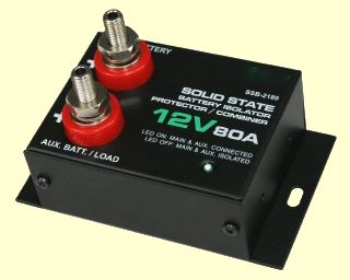

    I suppose I haven't been serious enough about creating this system to look into the cost of an isolator—I know they use 'em on motorhomes and such. But if you say they're about a hundred bucks, that's cheaper than an inverter and a battery charger. It's just the "redneck tech" in me wanting to reinvent the wheel, lol.

    I think they are like $100 or $150
    I know one persone running each of them systems too. now that I think about it the guy with the big batteries I think is running the factory made isolator.
    I'm just thinking the less extra wiring in a truck the better. too many chances of a fire

    I found a couple of places for isolators
    powerstream
    hellroaring

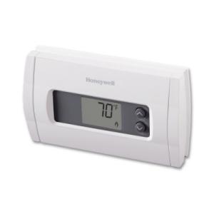

    also an electric driven ac compressor ( b2bmotor-manufacturer) that could be used full time for driving and rest eliminating the draw from the belt driven compressor and reducing the cycling of the fan if you tie it into the existing truck AC system. Along with a set of set of 4 d34 blue top optima's for power, this would save fuel, minimize additional parts and a heck of a lot less $$$ than any APU on the market. The compressor and blower could be cycled like a home unit using a digital thermostat like that used in the home since they are 12v activated.
