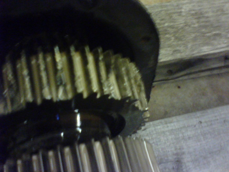

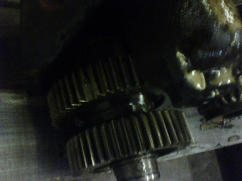

    We (Rob and I) were finally able to get together and work on his truck today. Between Rob and Hwypilot running their tails off and myself running out to Idaho and back and forth and then Thanksgiving it's been hard to schedule a time to fix his truck. But we finally managed. That's the good news...... The bad news... he needs a complete Transmission. Removed the Aux. (rear) box this afternoon found more damage than was expecting. Splitter gear (center gear in picture) was completely stripped, splitter yoke was bent, and splitter countershaft gears had teeth knocked off. R/S Countershaft bearing race had spun in main transmission case causing bearing to fail which allowed countershaft to misalign which wiped out the splitter gears. All these failure are more than likely due to the Transmission cooler leaking coolant into the transmission. We replaced the Transmission cooler a few weeks ago so we could add antifreeze to his radiator since it had plain water in it since the motor mount repair.
    We found a transmission for his truck already, just need to remove his and reassemble for a core. We won't be able to pull trans out and exchange until Tuesday since I have to go load tomorrow and deliver in Baltimore Monday AM. I'll work on his wipers and finish the roof repair when I get back tomorrow after loading. It won't be long and the Purple Hippo can dance again!!!!!!
