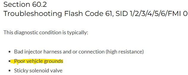

    Series 60 DDEC V Troubleshooting - Section 60.2 Troubleshooting Flash Code 61, SID 1/2/3/4/5/6/FMI 0 - Detroit Diesel Engine Troubleshooting
    RepoweredRookie Thanks this.

    Thank you for the response JB7. I went to Freightliner today to get some tools out of the truck and advised the mechanic of the troubleshooting steps you sent me. I recently just replaced the alternator, and the first step in the process is check alternator ground. The mechanic stated today he checked ECM ground and they will be doing an roadtest tomorrow, and then a dyno after that. Seems different than the troubleshooting process.

    You Sir won the challenge. Unfortunately I lost $9K to Freightliner doing the injector harness and full set of injectors first, then an extended road test until intermittent fault, then ECM change.
    But it’s an expensive learning lesson. Thanks for the response.
