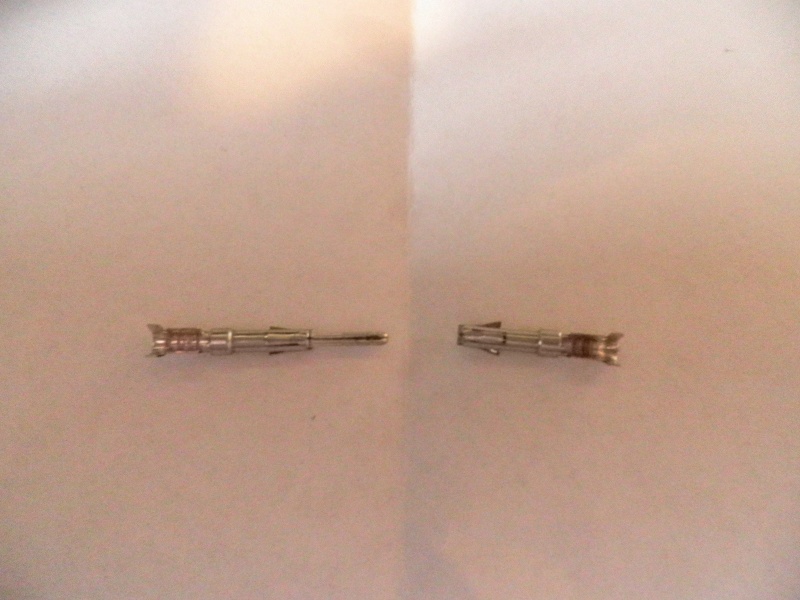

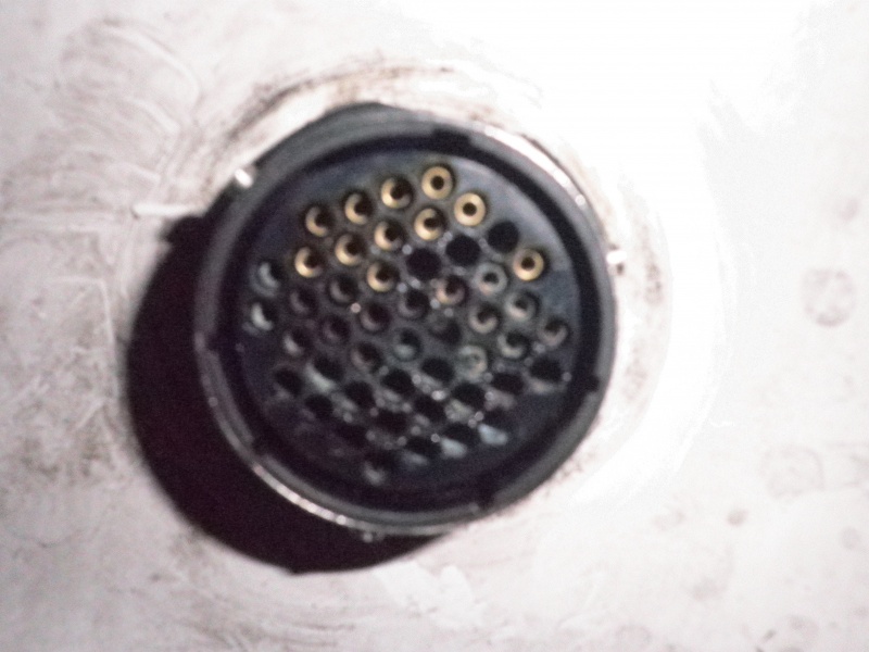

    This post is FYI. The info and pictures are from a 2004 9200i. Of course all trucks are spec ed a little different the part#s listed and pictures should apply to most 9000 series international trucks.
    On the drivers side lower fire wall there is a electrical connector that handles most all the wiring from the ABS sensors + other accessories depending on your truck.
    This connector has no rubber seal between the two connector halves this allows water to enter and corrode the terminals.
    In my case the corrosion was so bad many of the male terminals were no longer making contact and broken.
    The connector on my truck has 30+ wires running through it from multiple different wiring harness's . Replacing all wire harness was not an option.

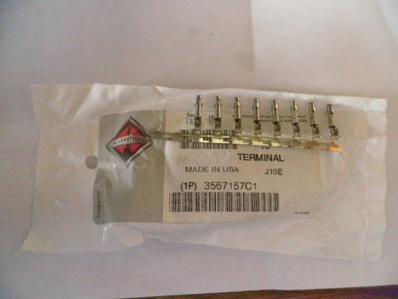

    International has replacement individual terminals for this connector picture shown below. Don't expect your dealership parts department to be much help, mine took 3 days and still could not find the the part#s.
    I was frustrated drove to my dealer and spoke to the service manger 15 min later he found the correct terminals in stock at the same dealer. I guess the parts department was clueless?
    Be proactive and take a look at your truck's connector save your self time and money. The connector has a collar on it, turn it counter clockwise to release. Put some die electric grease on the terminals if they look ok.
    If you need to replace the terminals they require a special tool to disengage the tabs that hold them in the connector. I will take another picture of the tool and post it. This is a Deutsch style connector.
    Male terminal part# 3567154C2 Female 3567157C1

    You may want to unhook the that cab connector I have pictured in the 1st post and check and make sure none of the terminals are corroded or damaged. Water can get into that connector and cause problems.

    I pulled it apart one prong broke in half looks like one completely missing hoping to find those connectors and tools thanks
