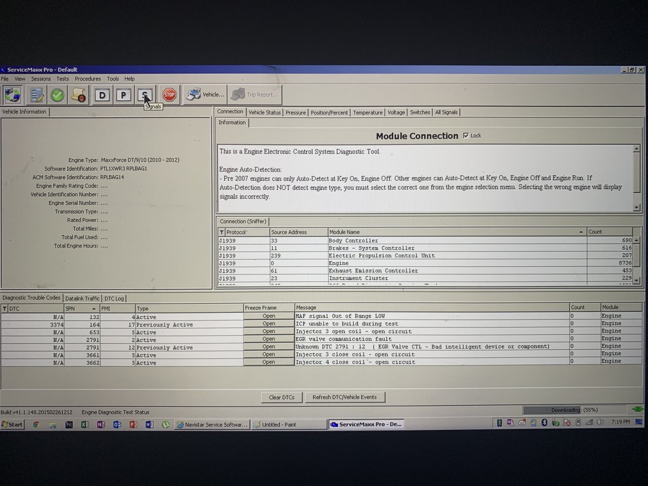

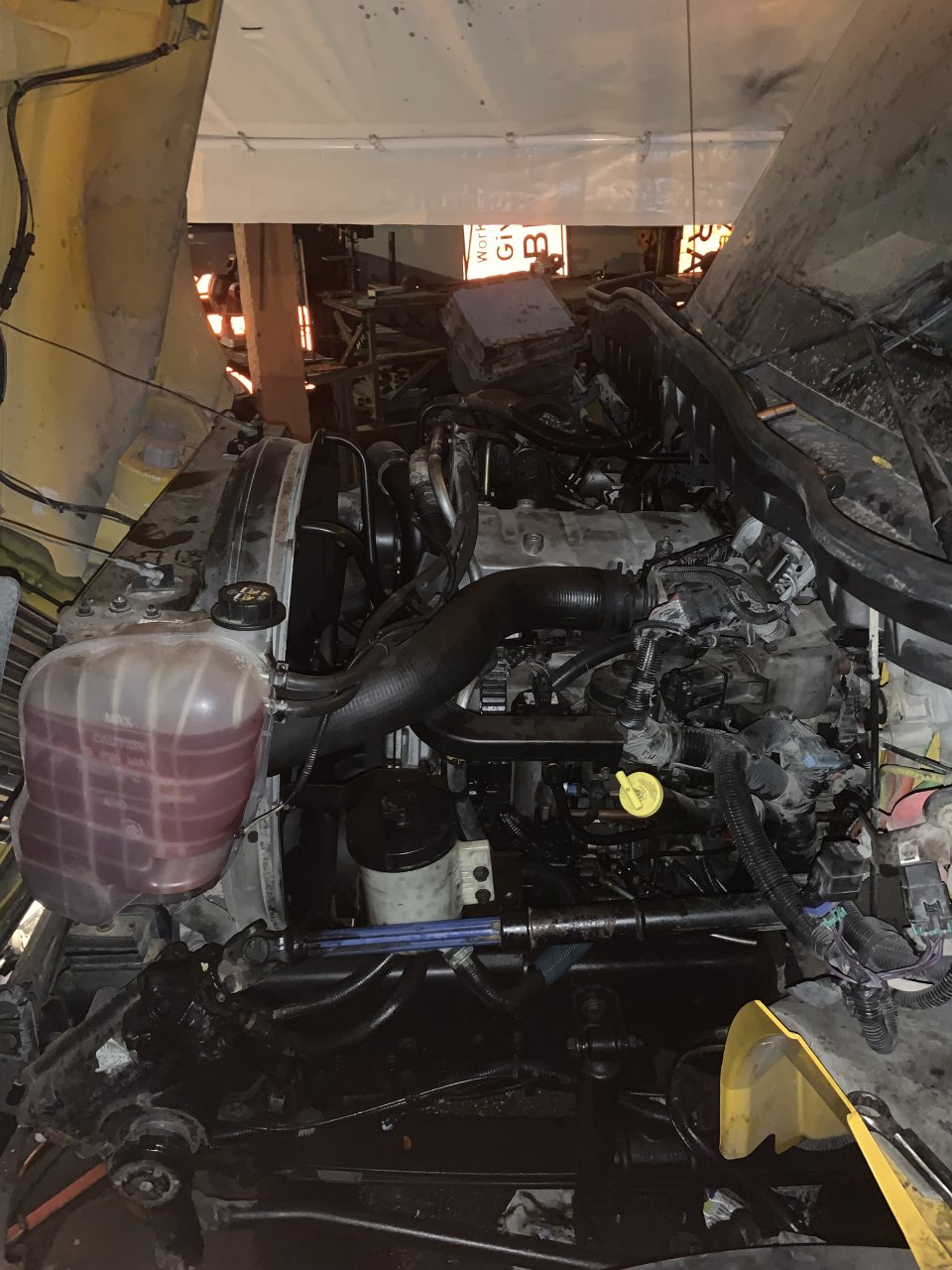

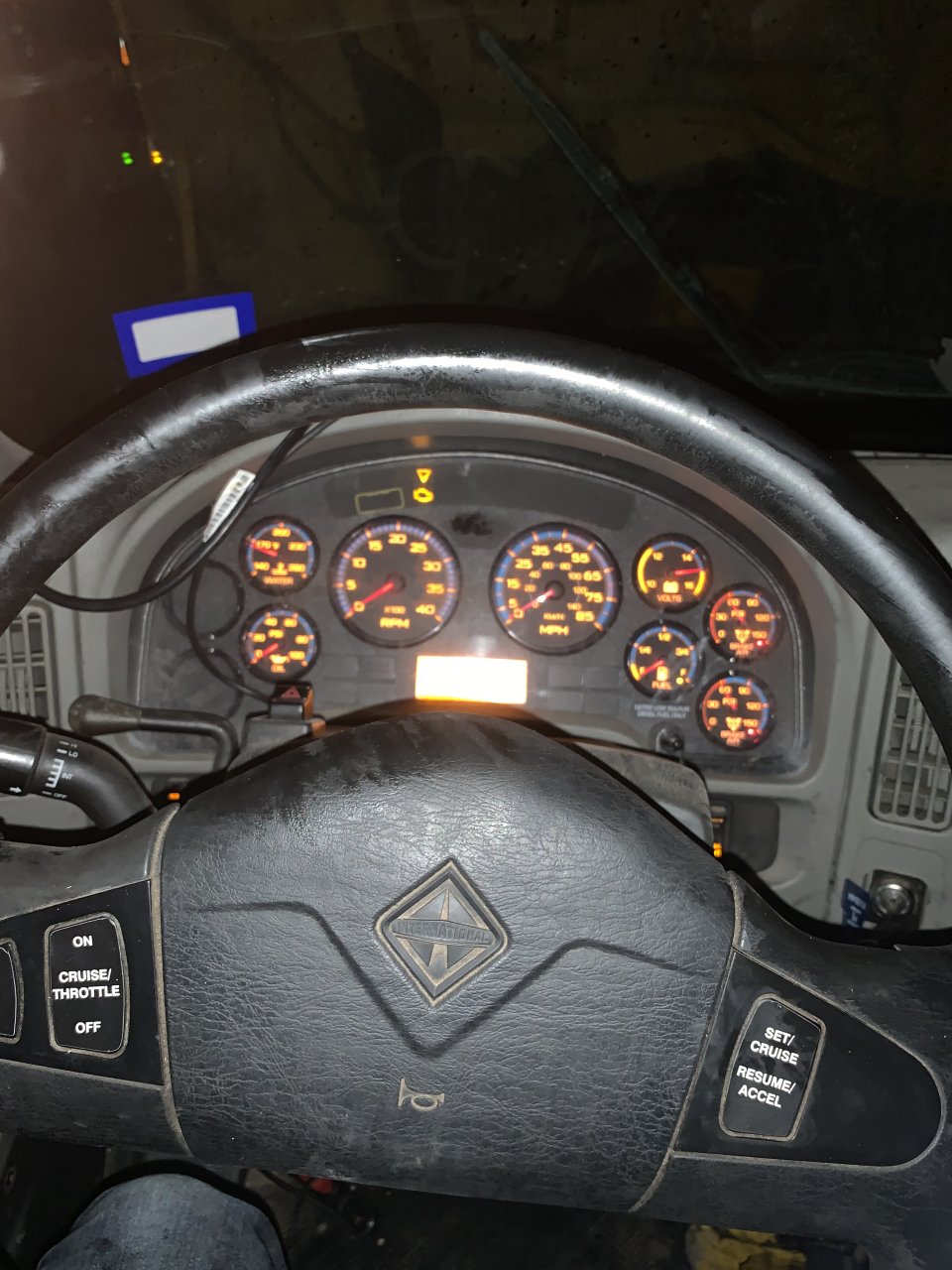

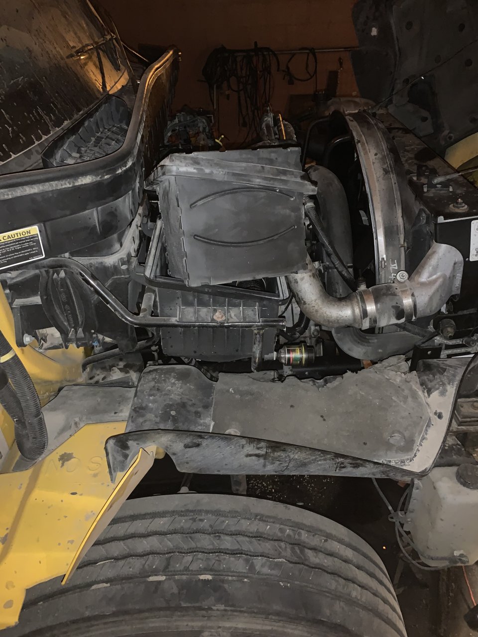

    I uploaded a bunch of pictures of my precious baby and found some trouble codes that might help someone point me in the correct direction?
    im not sure entirely what the trouble codes mean but when i did the injector shut of test 3 and 4 didnt make any difference. I still dont see why that would cause it to shut off though

    You are using ServiceMaxx. You can see ICP pressure in two different areas. First is under the "Pressure" tab. The other is under "Test" and then select Hard start No start or Performance Snapshot. You need to watch ICP Desired, which is what the ECM wants, and ICP pressure itself and see what happens.
