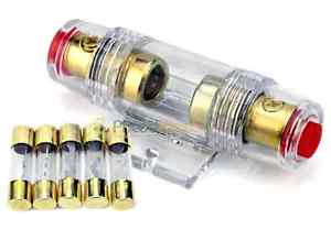

    High Quality Gold In-line 4 or 8 Gauge AGU Fuse Holder + 5 Pack 50 AMP AGU Fuses
    Best place is close to your inverter so your not outside in weather trying to change a fuse

    Inverter fuses stay in the battery box close to the source just like the breaker box in your house. You can buy good jumper cables. Drill hole in floor and run along underside of cab then into the battery box. Follow directions as to what gauge wire to use. Chances are jumper cable wires are much larger then you need so you may need to cut some of the strands off to get into the inverter holes.

    1st your right about having the fuses as close as passable to the batteries just in case,
    2nd i would never use jumper cables, as most are to thin and IMHO to light to take the load long term.... i would also not use the wire kits that come with the inverter for the same reason.
    with i used is 250 amp welding lead.... or you could use the same size wire as you starter uses. both will take the power. thicker wire is more efficient, thinner wire will have more resistance.... resistance = heat, heat = FIRE
