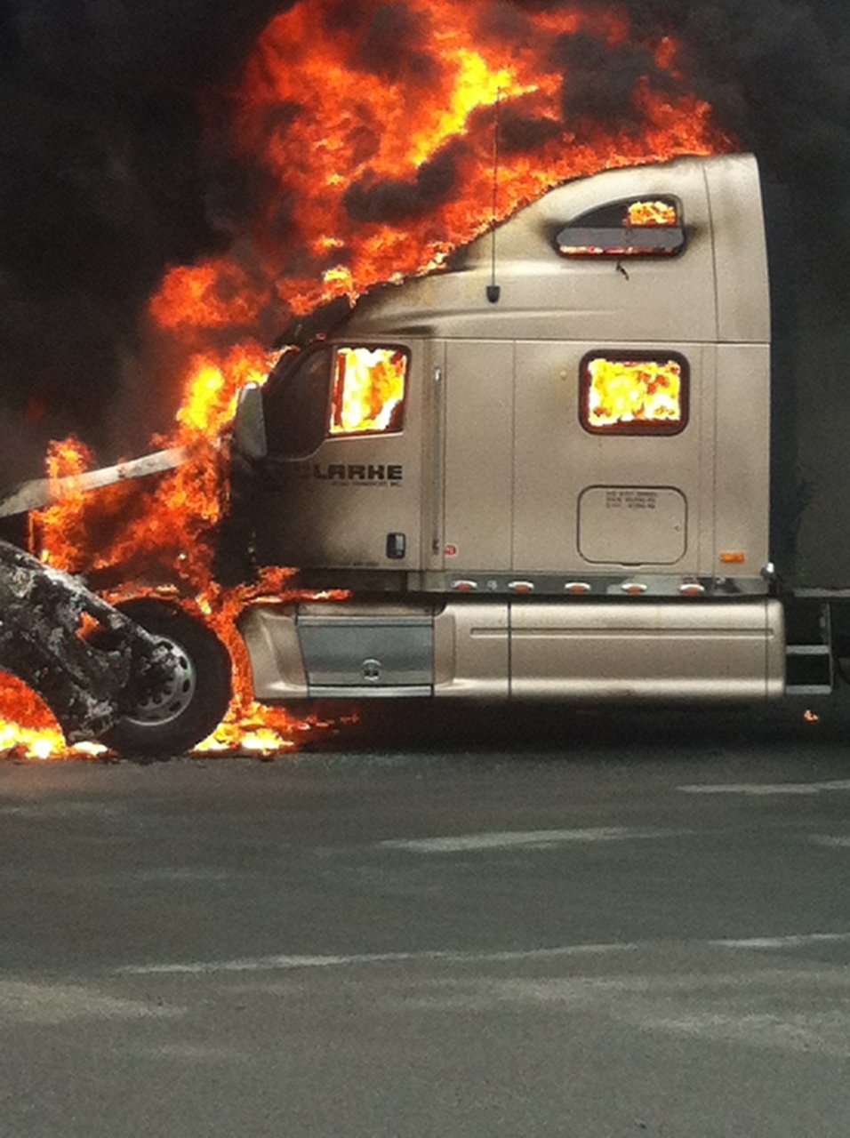

    For 3000 watts and say a 12 ft run of cable he needs 000 and fuse it at 250 amps. Make sure any places you go thru the body or around corners or where ever you tie it down you have LOTS of insulation around it to protect it. Every months have a good look at it all to make sure it's not getting chafed thru. Too many drivers die in fires started electrically. I missed it by one day. Previous owner did some wiring on a truck I bought and it went up. Thankfully on Monday not Sunday or I would have been asleep In side.

    I owned this for almost 2 years ....
    And then this. It was wiring by the previous owner, who said it was done by the dealer, that chafed thru. I know I've posted it before but if I can help 1 driver not have this happen I'll gladly post it every day.

    Looks like it started under the hood. Was it wiring under the hood?

    Started between the inverter that was behind the drivers seat and the battery box below the drivers door then from there to the starter when that shorted.. or the "investigator" from the insurance company said.
