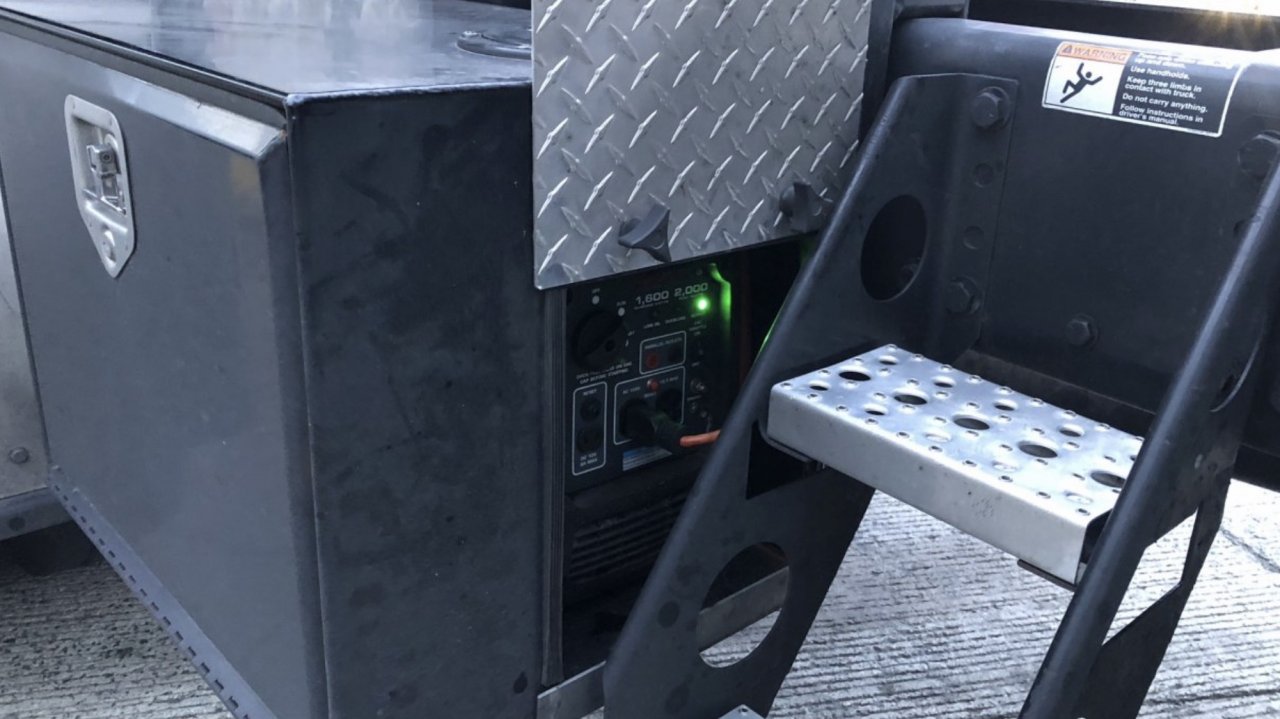

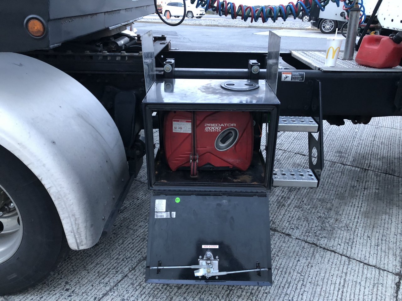

    It’s a harbor freight 2000 watt inverter generator.
    I run synthetic 10w 30 motor oil in it and I have been running it for about 3 years now.
    It was cheap enough that if it had a major failure I would just throw it away and get another one.
    Here are a few more pictures of my set up. EC77FAEF-C83E-44AD-85F0-25BD50041931.jpeg F7FB0F7B-9123-4E80-885E-DEE782B8A67A.jpeg 254B09CD-7E45-4AC3-A8E4-6CD2ADDA0584.jpeg

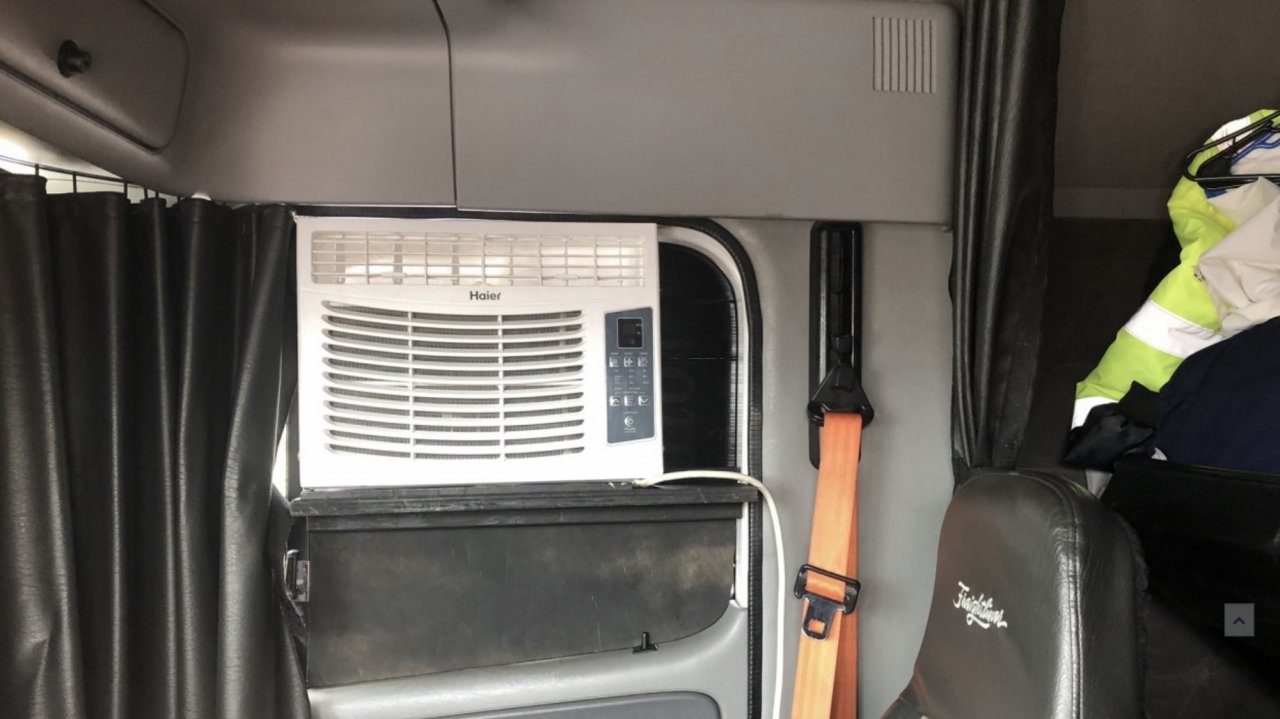

    The generator runs the window AC for my whole 10 hr break on one tank of fuel.

    I do not run an extra fuel supply at this time but I carry a 2 gallon can that I refuel it with.
    The gen box I bought in tractor supply and I made the doors from aluminum diamond plate also purchased from tractor supply.
    I also made the brackets that the box sits on and they are clamped to the truck frame with no drilling or welding.
    The exhaust is vented out of the back of the box at this time but I have fittings and flexible conduit that I have bought to tap in to my stack pipe under the cab but I haven’t got around to completing that part of the project
    yet.
    I also run a battery operated carbon monoxide detector in the cab for any safety concerns but I have had zero problems with carbon monoxide gases.
    If you need more detailed pictures of how mine is set up feel free to ask and I will get them to you.

    I believe the AC unit is a 5500 BTU unit.
    The unit itself is just a run of the mill cheap air conditioner I bought at Walmart.
    When not in use the window mount and AC unit are stored under the bed in the bunk.
    There is a way to run a remote fuel tank if you needed to.
    You would mount a remote tank somewhere of your liking and you use a cheap pulse type fuel pump from a lawn tractor.
    I have seen YouTube videos on remote fuel tank set ups done this way.
