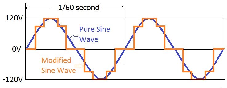

    pure sine wave is what you have in your house (clean power) modified sine wave (dirty power). the wave is not the same and some things REQUIRE clean power like TV, some COMPUTERS, PRINTER

    I had a modified sine wave 1,800 watt inverter that did everything I ever wanted, but when I bought an induction cooktop, it would not run. The electronics in it are not compatible with a modified sine wave inverter.
    I installed a 2,500 watt pure sine wave inverter and everything worked great after that. Even the microwave worked quieter. Your 0 gauge wires are probably large enough.
    A pure sine wave is like the waves in the ocean, the voltage gradually goes up, then gradually goes down. Nice and smooth.
    A modified sine wave is a crude digital representation that is very choppy.
