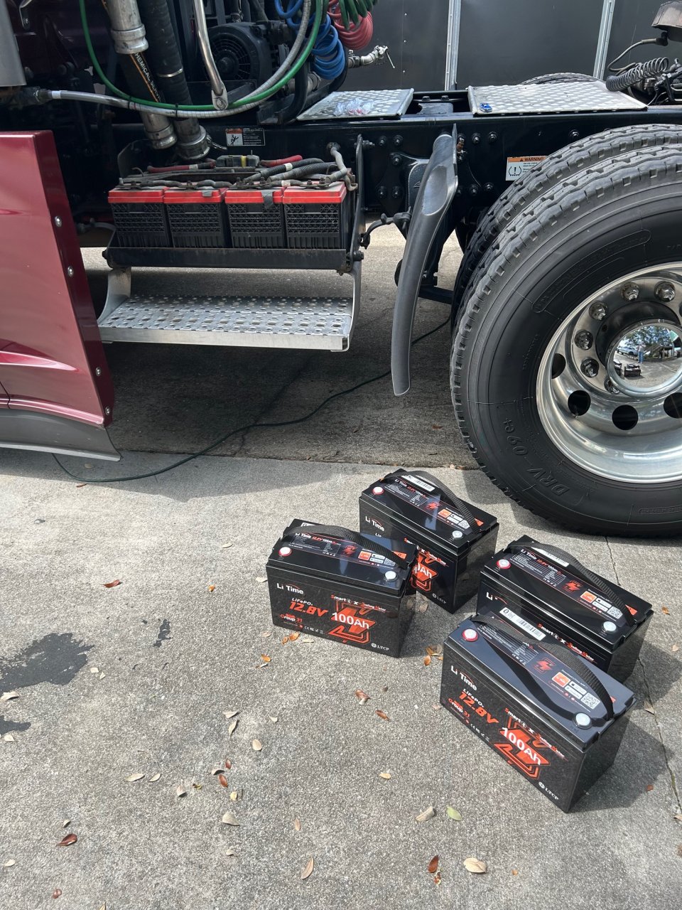

    Major electrical surgery to my rig this week.... Took 800 pouds of OdysseyAGM31's off my truck.
    Replaced with about 300 Lbs of Lithium. All new solid copper connections. Had to buy the hydraulic crimper for 4/0 extreme stranded cable, and llugs, and CRC-Di-electric grease.
    Added in the Victron Bluetooth enabled 3 bank charger for full control when I run my genny on restarts.
    Blue Smart IP22 Charger - Victron Energy
    That thing is tits being able to control, on the phone, what voltage it pulls from the genny.
    I still got 2 AGM's mixed in the started bank, could not afford to go "all in" because just bought those Odysseys' in Feb'24.

    Looks like a nice clean install. I think that #4 wire is a good thing as well. I've read where guys used #6 wire and got error codes on their a/c at max cool. From what I've seen those a/c units can pull as much as 60A at max cool. The charts I looked at called for #4 wire.

    Very nice install. I think you could have saved the 2 other batteries and put them up for winter time or something later on. You will find that with your other lithium batteries you will have enough to do a 34 more than likely. Will be interesting to see what your results are putting them together like that. Did you have a tie down on the starter battery set up? That is one thing I would make sure it had with the lithium batteries. They may not last very long if bouncing around.
    I don't think you have solar on your truck either do you? I have one panel and it seems to work fairly decent in keeping the lithium batteries topped off when truck is parked with camera system running 24/7. Also I am sure that you charged the batteries 100 percent before installing?

    Depending on the year of the truck some of that information is incorrect, Cascadias built after 2013 and the new X line of Western Stars no longer have that solenoid separating the batteries. All 8 are directly connected.

    I've seen it pull 55A across all 8 batteries if I add up the AH from all the batteries with nothing else on.
