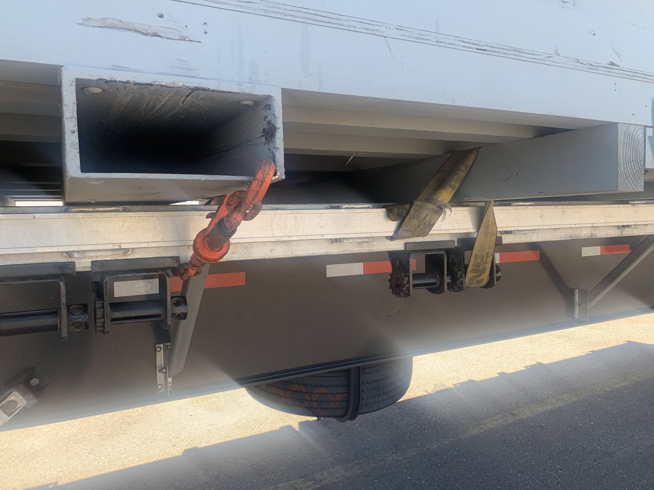

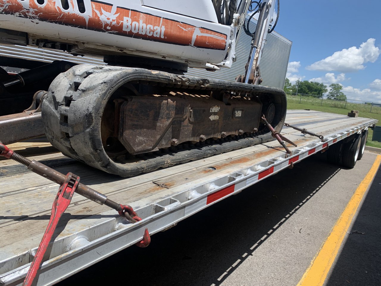

    perfectly legal, it’s done all the time. ED5D6ABB-B82F-4E87-9915-192238D3A403.jpeg D1335FF7-B9B8-4573-AC38-20ECEAAE030C.jpeg
    legally anchor points are not required to be rated. Any rubrail can be used for securement.
  9. PoleCrusher
    PoleCrusher Road Train Member
    7,503
    82,194
    Aug 26, 2014
    LLMF
    Thanks for proving my point, as stated, you either know or you don't know, and blindly taking advise from another driver does not count as knowing, regardless of their experience.
    Let's see what a manufacturer has to say, since they're the ones who actually do the designing and building...
    "One part of the trailer that’s more frequently damaged is the rub rail, or tarp bar as it’s sometimes called. It’s not considered an anchor point in most cases, yet some drivers insist on using it as such. Securing cargo to the rub rail is not a recommended practice, Sabol adds. “In fact, at East we do not even rate the rub rail, because it’s not a recognized tie-down point. Drivers are not supposed to connect hooks or straps directly to the rub rail.”
    Don’t Overlook Trailer Anchor Points
    Oxbow, BigBob410, cke and 1 other person Thank this.
  10. Nostalgic
    Nostalgic Road Train Member
    1,815
    20,015
    Mar 6, 2017
    PA
    It didn't take me long with my new East before I scraped the "Do Not Use" stickers off my rub rails. Sometimes it's the only useful option.
  11. kylefitzy
    kylefitzy Road Train Member
    4,754
    19,808
    Aug 12, 2007
    Kansas city,Mo
    That’s good info to consider. I will continue hooking to the rubrail when necessary. It’s perfectly legal and never had an issue. Obviously you should be inspecting equipment for cracks and damage.
