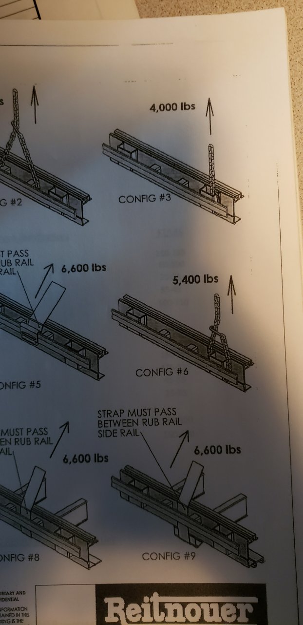

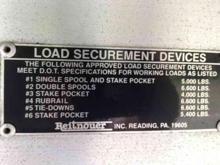

    Really depends on the manufacturer..
    Reitnouer rates their bump rail @6600lb on some wagons

    Benson also rates their rails at 6600lbs.

    Here's an idea, if you want to be able to use your rub rail as an anchor point, buy a trailer that’s built for it. The rails on my trailer have a WLL of 5500 lbs, rated by the manufacturer. Singlescrewshaker posted a Reitnouer with 6600 lb rated rails. This isn't hard, buy equipment that will do the job you want it to.

    Why is #3 and #6 both “stake pockets” and list 2 different ratings? Am I missing something?
    cke and singlescrewshaker Thank this.
  9. JonJon78
    JonJon78 Road Train Member
    7,248
    43,363
    Jul 1, 2018
    It depends on how the pocket is used.
    Speed_Drums, cke, not4hire and 6 others Thank this.
