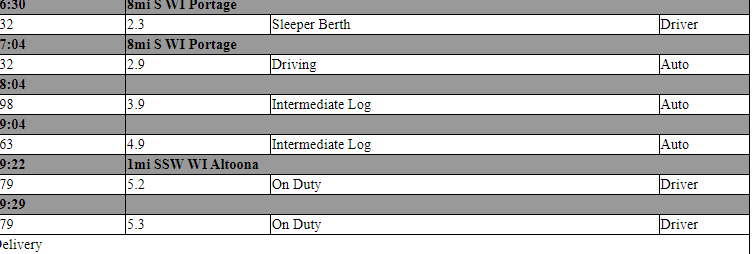

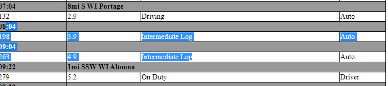

    The intermediate log location seems to be a newer rule that requires ELD system to log location every hour, during drive time - line 3.
    Evidently, Garmin - as at least as of last October - when I used it while my KeepTruckin was done, failed to do so. As you can see from the figure below, there are no location entries between Portage, WI and Altoona,WI while the truck was in continuous motion. There were supposed to be two location updates.
    If, indeed, these locations are a mandatory DOT requirement with regard to ELD then Garmin needs to do something about it.

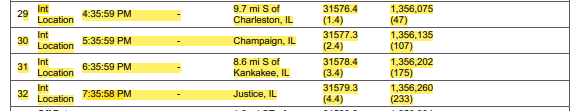

    Here's the example of Keep Truckin showing intermediate log locations:
    during 3 hours of continuous driving - truck did not stop - the locations were logged automatically by ELD. That requirement did not exist with paper logs.
