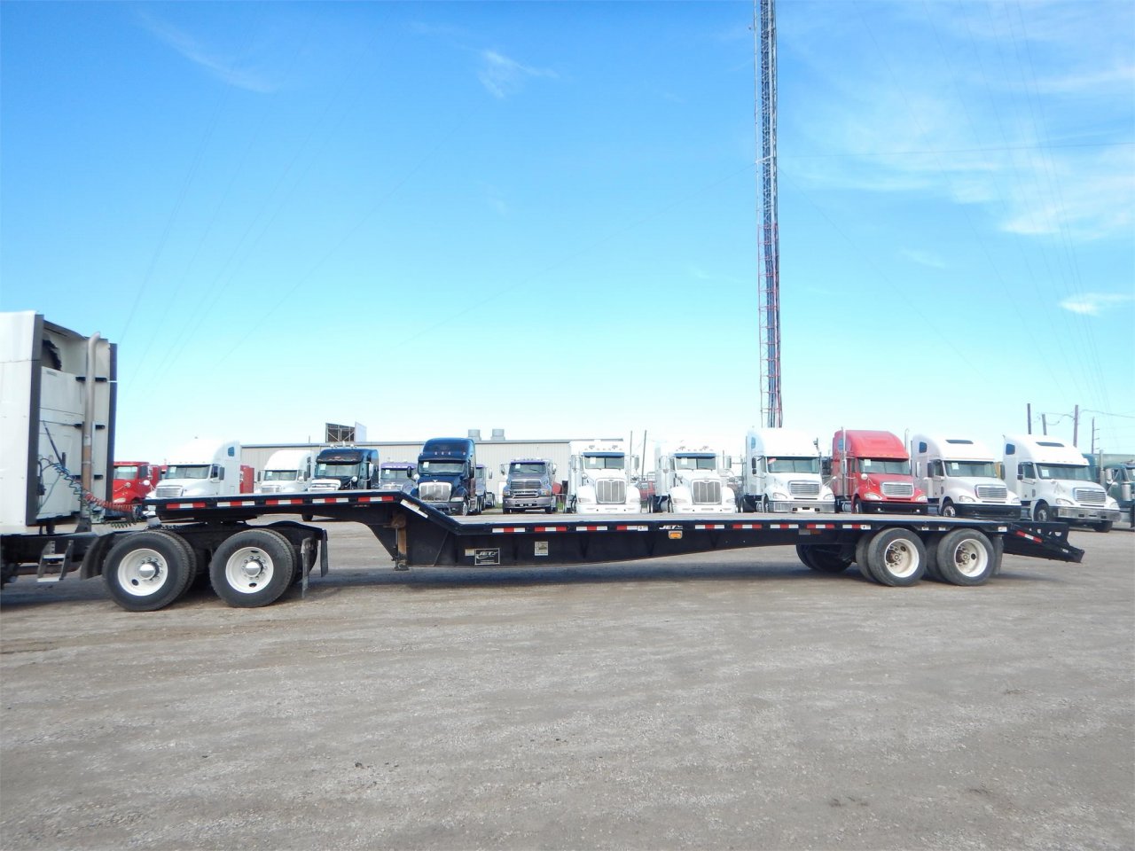

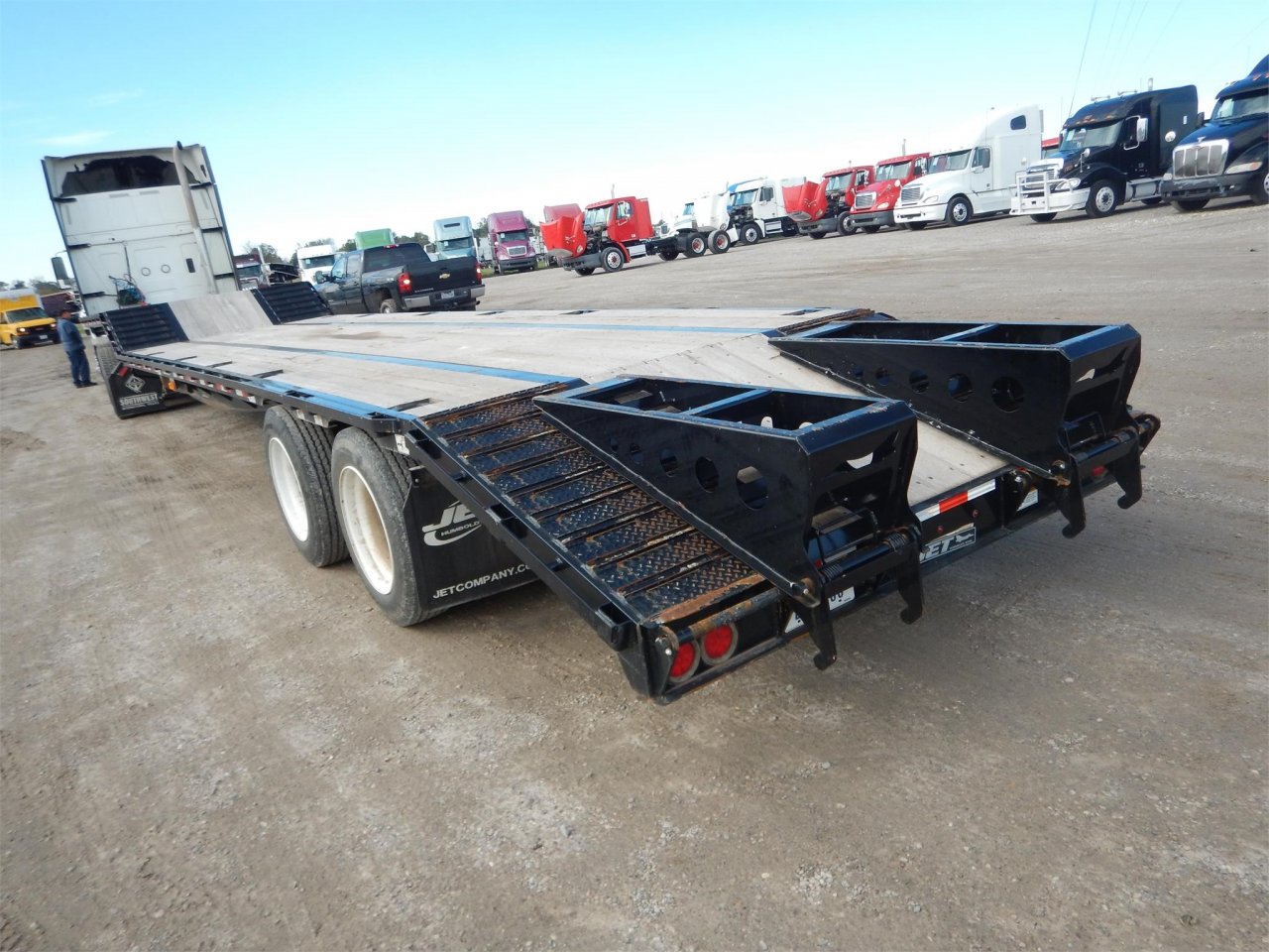

  8. Bdog
    Bdog Road Train Member
    1,057
    877
    Nov 6, 2014
    I found this trailer for sale about 7 hours away.It is a Jet 35 ton 48'. It has the tandems but they are pretty far back. The slope leading to the upper deck would be nice for loading my stuff up there. It is about 5k more than the other one I posted though. Thoughts on it?
  9. cnsper
    cnsper Road Train Member
    5,869
    27,421
    Feb 28, 2014
    That looks like it would be perfect for what you are wanting to do. You can either deal with the off tracking or tail swing. Personally I would rather deal with the off tracking, I can see that better.
    Now that you have said that you haul rubber tracked and utility vehicles, there would be no issue with you offloading in the street if you need to.
    Me personally, I prefer a sliding axle but that is probably out of your price range so I would go with something like that Jet you posted. Nothing wrong with that trailer.
