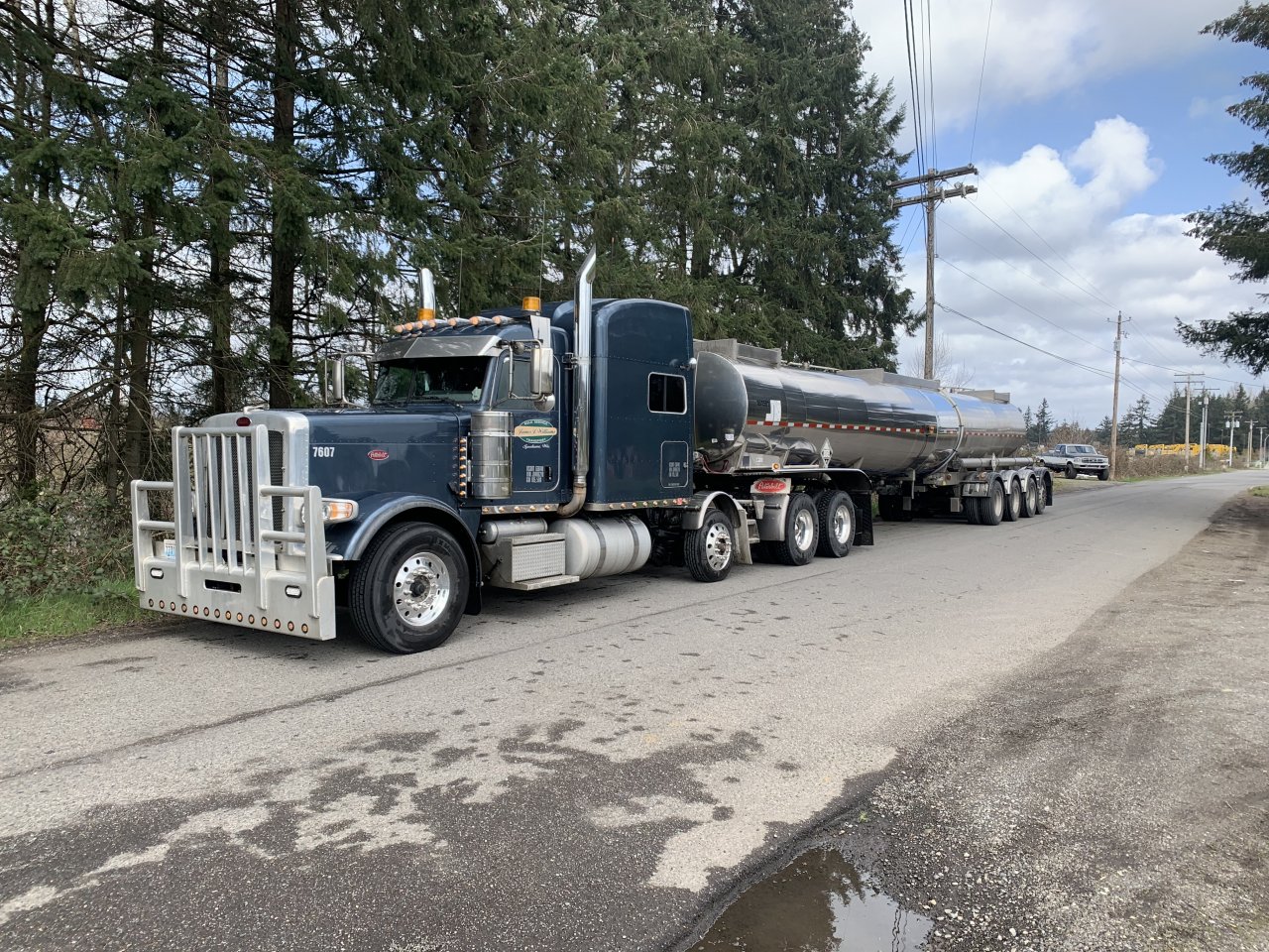

    Cool deal. Mine’s not a huge sleeper truck but she’s a 312” wheelbase.
