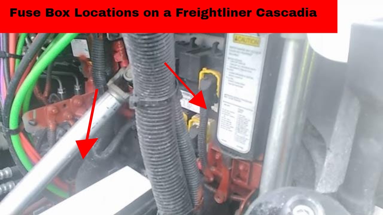

    I have a 2013 Cascadia with Cummins ISX . When changing batteries I made the ultimate SCREW up and mixed up postive and negative . The unit will now not turn over and in the dash the display screen shows " no eng " I contacted Freightliner they advised ECM burnt up which I kinda figured . But I can't believe there is not some type of Fuse protecting the ECM. I checked every fuse I could find . Is there a fuse some where in the wiring harness I'm missing ? Thanks for any help you guys may provide .

    theres ecm fuses in the battery box i believe at least on my century i had

    did you check fuses behind glove box and under the hood.
    habfleet and Rideandrepair Thank this.
  5. truckdriver31
    6,988
    8,343
    Sep 18, 2013
    5CE98908-427E-42D3-8CDC-2C91DFA5AB96.jpeg should be #8 20 amp fuse

    Positive reversal will go through all fuses. The ECM is likely gone along with anything else plugged in that has a brain. Once it powersup on the wrong polarity shorts out instantly.
    I install computer power supplies when building machines or replace them and for the most part the polarity is idiot proof. If it does not flow correctly for any reason there is no more computer.
    In a fuse it carries current. Either the right kind or the wrong kind. It does not know.
    What fuses do know is that when there is too MUCH current they get hot and fail. That is all they do. Fail. Before there is a fire or nearly so.
