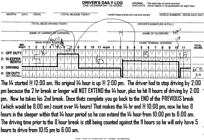

If he was attempting split break he would still be in violation! The driver did not have 8 hours in the sleeper so therefore he/she could not have driven passed that 14 hour mark! Remember once you enter lines 3 or 4 after a complete 10 hour break (or longer) your 14 hour clock starts, there is NO WAY to extend or stop it UNLESS you have 8 HOURS IN THE SLEEPER (ALL 8 MUST BE IN THE SLEEPER AND CAN BE MORE THAN 8 BUT ONLY THE TIME IN THE SLEEPER WILL EXTEND THE 14 HOURS).
So if I drive 5 hours and sleep 7.75 I must still stop # the 14th hour and take # least 8 hours in the sleeper!
If I drive 5 take a 2 hour break (can be line 1&2 combined w/e as long as no line 3 or 4 time) then I must still stop # the 14 hour mark but i only have to take # least 8 hours in the sleeper, but the driving time prior to the 2 is still counting towards my 11 & 14 hour period.
Brief scenerio of split breaking, I am going to post some examples of it , later!
Once everyone agree's/understands the 2 examples above! If you don't understand the above you can't split break! Splitting is VERY VERY VERY EASY AND SO IS THE 11 & 14 HOUR RULE! This is to all drivers not just "silver" -

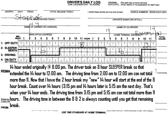

Ok LogLady--so if you take an 8 hour break to split break--how long does that extend your driving time? (this is where i get confused--the reason i try not to split break)
I know kind of messy
Always assume I start all logs with a full 10 hour break at the beginning of the day
Please ask questions !Attached Files:
Always assume I am starting with a full 10 hour break in the begging

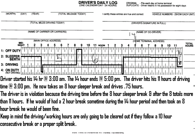

This one has a log violation with a driver attempting a split break
Ok done for the night, don't like the paint stuff, looks sloppy, sorry
My little feelings are hurt, no ONE has responded?
Your still confusing me!
I get the first one and the last one--i dont get the second one!
