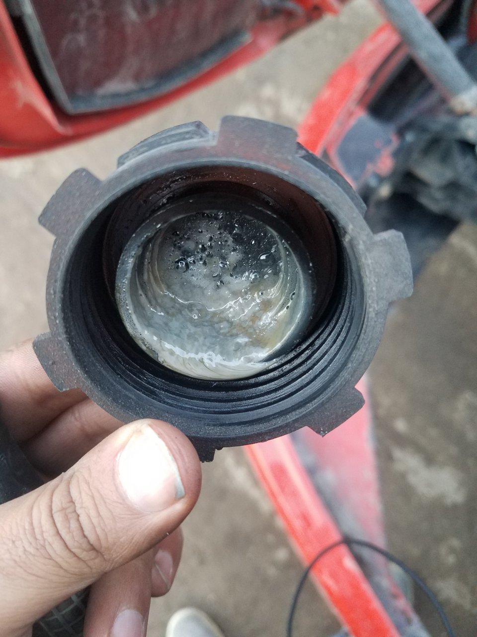

    Hey guys so i was doing some thorough inspection of my truck and i found this under the oil cap.is this a coolant leak or it just happens in winter season .i am taking my truck to pete dealer tomorrow to get it checked anyways as it is still under manufacturers warranty. any suggestions or help is appreciated. Thanks 20200207_164337.jpg

    I don't understand what is that liquid made of.
    ALL oil caps I ever saw usually had oil on them. Not that grey stuff. The shop will need to examine that and see whats going on if anything.

    I'm no expert but I don't like how it looks
    But I hope it's nothing serious

    How does the oil dipstick look at the very top near handle where you pull it out from, any white junk on it, you need to run a oil anil. on the oil before its changed?

    you have coolant in your oil. take it to a shop

    Have you sent out a oil sample to be lab tested?

    10-4 on the oil analysis - then you know.
    Anything else is speculation.
    Sure does look like coolant, tho. Antifreeze smell?
    If unit was NOT under Warranty, i would suggest just wiping it off, and seeing if it re-appears.
    There's a possibility that could have been there forever, and just not noticed until now.

    Its clean no white smoke from exhaust either .oil analysis was run 30k miles ago no sign of any coolant but anything couldve happened in those 30 k miles .

    No smell no smoke . Ive just talked to the mechanic and he said most of these cummins make that white grayish slime when you cold start them .but i am still little iffy about it so omw to the dealerahip to get the head hasket and coolant pressure check .

    Could be just slight condensation that developed from the temps going from cold to hot to cold quickly in a high humidity environment, particularly if the truck sits for a few days. Kinda like how the outside of an uninsulated toilet bowl will drip water in hot temps with cold water inside.
    But, there may possibly be a slight coolant leak, or water from an outside source that got in there somehow, rain, washing, etc.
