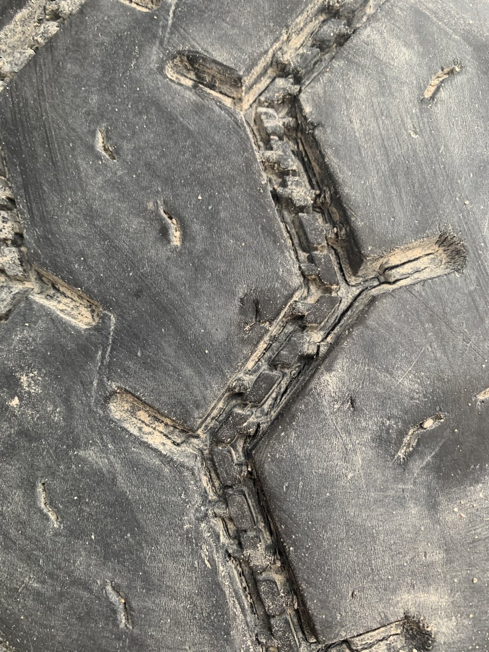

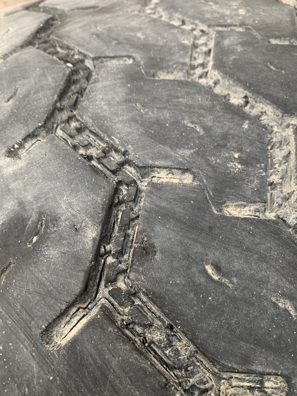

Is this cracking bad enough to cause a blowout? Steer tires.

    Using this pic as an example of what type of tire that tread is in the OP pic....
    Wide Base tires are some of the most explosive type of tire to have on a steer of a truck. 120 plus psi of pressure, a lot of volume of hot air inside when they’re loaded.
    When the rubber starts cracking, the water gets inside, corrodes the steel belts.
    Then when they blow, they blow. There goes the hood, rim and everything in the area.
    There are two types of explosions happening at once.
    One is the tire, the other is the jet of brown s*** shooting through the driver’s seat as the person desperately tries to get control of the truck back as it careens out of control.
    I myself have no idea. Never happened to me yet. Just based on what I’ve been told by our company and other company truck drivers.

    Just wondering if the op was the one can hauler sitting at the Detroiter checking his tires and taking pictures of them yesterday? If so don’t get pulled over by Wayne county, they will put you out of service for steers like that.

    Steer tires have a 4/32 minimum, double what is required for the rest. REPLACE!!!!

    I would say yes....Put a penny upside down into the tread & if even or above Lincoln's head tire needs replaced..2/32/ for drives & 4/32 for steers....The small cracks are in the tread & not the sidewall which is more common & not as serious....
