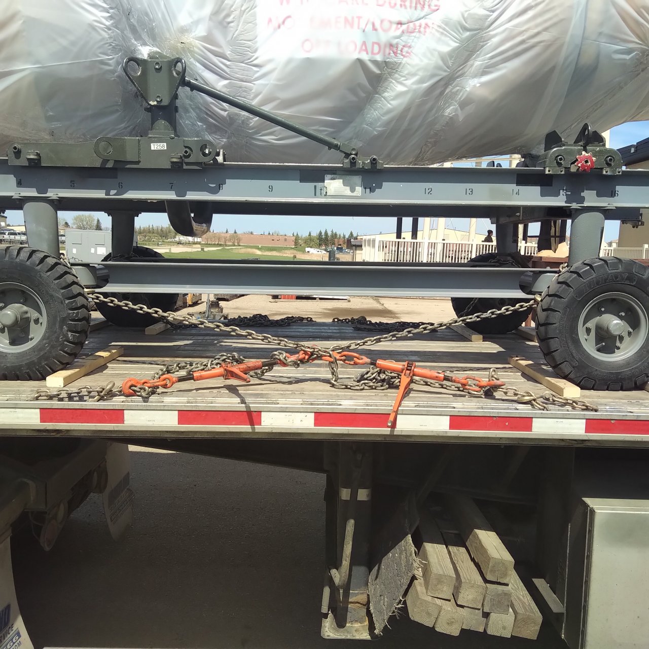

    Picked up these airplane engines . Shipper said they require chains to be crossed? Is this legal? And what does this accomplish?

    Yes it is legal but you should have chafing protection if the chains touch.
    I am surprised that they allowed you to tie to the upper frame support above the frame suspension.
    The long chains as you have them allow your load to have a soft ride on its tires as well as the upper frame suspension

    My hook ends were to big for the chain holes. I asked if i could wrap around frame and they said no problem.
    I redid chains to spread out binders so they not so close together.
    Thank u for the quick reply

    Looks good as it is..... You can add protection between your chains if you'd like.....I do sometimes but its not required.

    Legal and It dampens the shock and vibration to the cradle-car and engines. RR does the same thing with stuff like that.

    Not sure if it’s applicable, take the hook ends off, then when get thru the hole put back on.

    Surprised they didn't want them tarped.

    Yeah but thats gonna take an extra hour to do all that plus got to reverse the process at deliery. And no extra cotter pins if i break one

    i am trying to figure out how to get my tarps over it right now. Been fighting them for past 30 mins with no progress

    Ya, I knew those engine always get tarped.
    The forklift operator wont help you get the tarps draped over the load?
