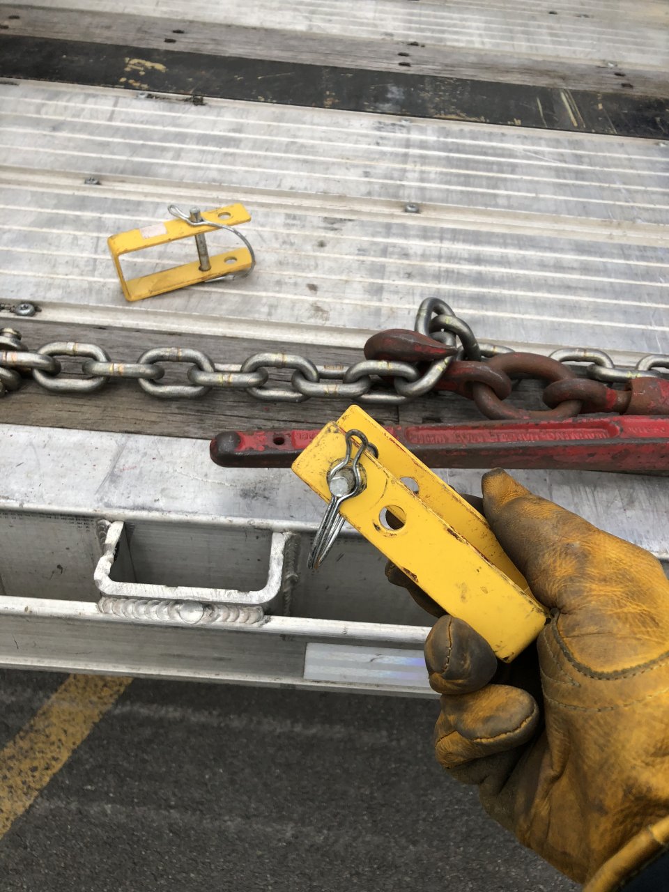

    Sticker on the back said $5.95.

    I seen those at Joplin one day, the price was 6.95 I believe. Not worth that imo, but what's my opinion worth LOL.

    [QUOTE="Ruthless, post: 8333966, member: 48360"
    @stwik
    Sticker on the back said $5.95.[/QUOTE]
    These are my favorite if I have to use a snap binder. The threads give you adjustment so you can get a half link tighter if needed. Built in spring latch to keep them closed. No parts to worry about losing.
    I use a 2ft pipe to release them though because the latches have to be held open while you pull on the handle and I don't want it to snap and break a finger.
