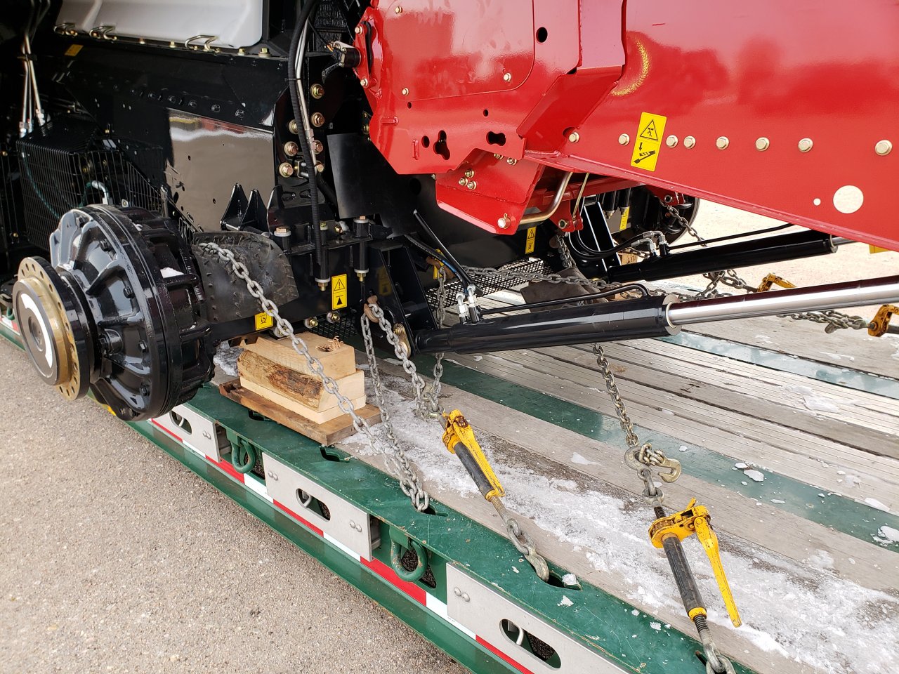

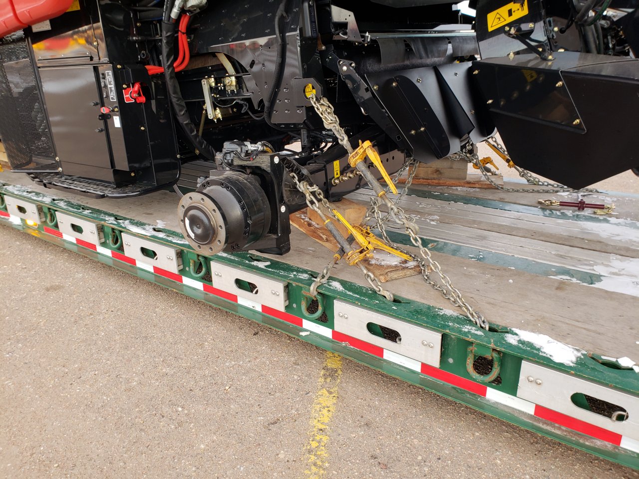

    @Army91W
    4 chains
    6 J hooks
    12 binders
    cke, kylefitzy, PoleCrusher and 3 others Thank this.

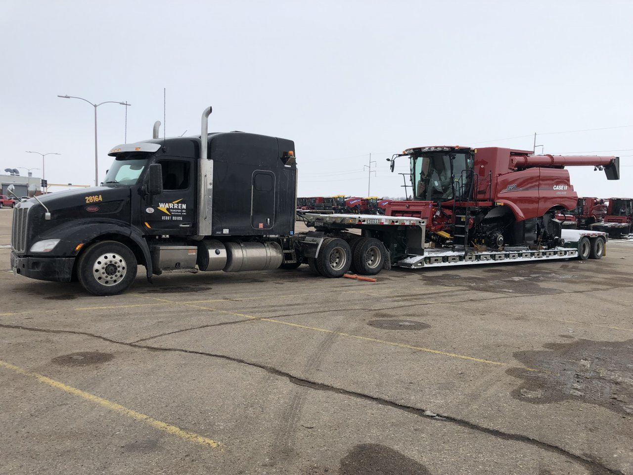

    Thanks for the photos.
    I called ahead for my delivery said I could be there by 4. They said they would still unload me. I didn’t think to tell them I didn’t have tires. Needless to say they weren’t excited to have to take off tires on another combine to unload me at 4pm. lol
    The guys at Case in Leland, MS are a class act. They stayed late to unload me and helped drag my chains to the headache rack for me to put away.
    I included some loads from the last week. The header picture wasn’t my load it was the guys next to me but I had the same thing. Not a camera guy.

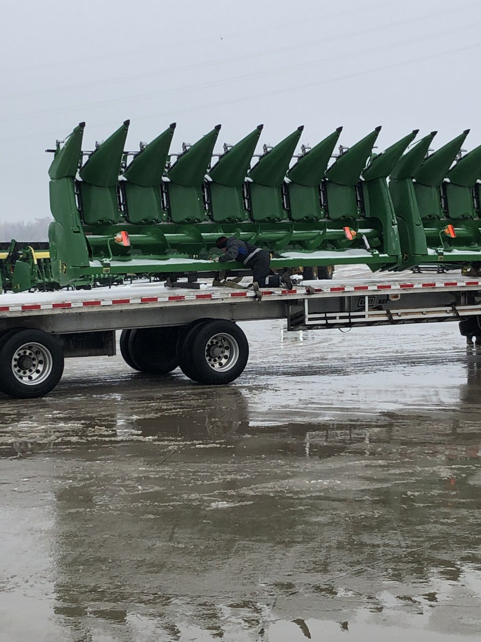

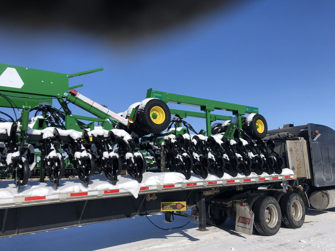

    C5C47807-82C9-4EE4-A916-B7869E5D3792.jpeg 0076E273-A90B-466F-88D7-8819CF4BBC7C.jpeg
    Just be glad you were not here a year or so ago. Washington state patrol was making a big deal about bungees being used as securement. Someone asked about tarps being used on a load. The office actually was telling us every tarped load needed straps over it. I’m glad that guy went back to drivers services and stoped giving securement advice before people started really damaging some loads. The customer would be pretty upset if we strapped over these loads.
