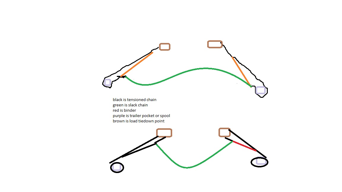

    you can use one chain and two binders in multiple ways if you wish. If you have a spool on the trailer you can run the chain around it and chain hook to the load, then hook the binder from the load side to the slack side. then do the same thing on the other side.
    you can also do the same with the loop at the load tiedown point and the chain anchored to the trailer. I hope the drawing will help.

    Don't mean to confuse you, okay? @johndeere4020 mentioned that in order for it to count as 4 points of securement, it has to be 4 INDEPENDENT points of securement. In your first picture, if you cut that one chain, both binders will lose their tension and flop loosely. If you loosen one binder, the other will be loose too. They are not independent.
    @Razororange in his illustration is trying to show that all you have to do is loosen some of the chain that you have around the binder, and use that excess to pull part of the chain that's laying across the deck and hook that to the bottom hook of the binder. If you do both sides and allow the slack to lay on the trailer, it will count as two points of securement. Secure the other side the same way and the attachments and you're ready to go.

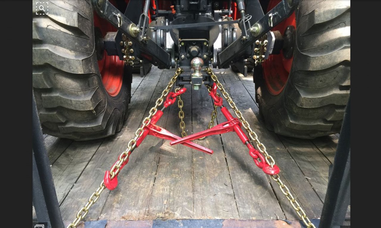

    You are on the right track kind of. Basically you use one chain, but 2 binders. You kind of split the chain in two. These are only pics I got but zoom in you can see one chain and 2 binders used to create 2 separate hook points with the remainder of the chain slack in the middle of the trailer.
    41BD10FE-F653-47EB-987D-EE07D83236A4.jpeg C29FB5F2-E2C1-40A5-9D8B-085D8488A79D.jpeg
  10. jamespmack
    @Hulld This pic is a good example, but you are on one point of attachment. Helps not one bit if that hitch fails. But this shows the chain and binder set up well
