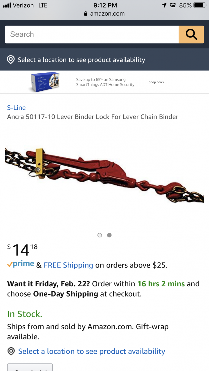

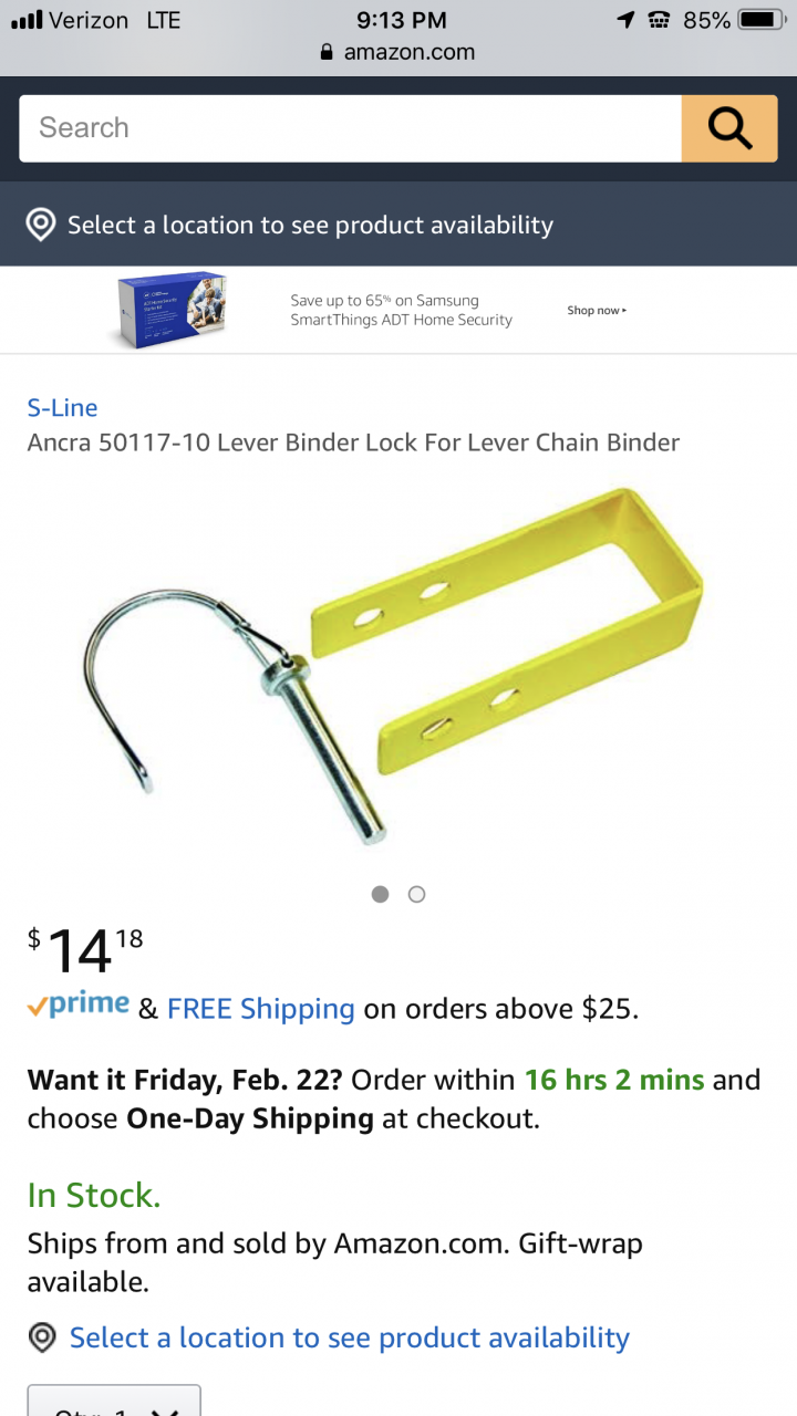

    You’ll be the only person I know that has them.
    Never met a soul at Melton that ever used them and I have never seen them in person. Period.
    I know they exist but until DOT whips me over it... I probably won’t ever buy them.
    Yet, $5 is $5....

  3. Tug Toy
    Tug Toy Road Train Member
    7,113
    74,430
    Jul 4, 2015
    Corn field
    I purchased enough for my snap binders. “8”. I think I found them for $7.99 each. There was no rating or size but there are 2 holes to chose from and plenty of slop. 27698633-FCB1-4258-9614-A59E4E40282D.png 955F8631-D9E6-41BA-9B1B-581E9F61214E.png
  4. JonJon78
    JonJon78 Road Train Member
    7,247
    43,322
    Jul 1, 2018
    Lever Binder Lock $5.99
  5. stwik
    11,887
    168,508
    So it’s a cotter pin and some bent steel...?
    Alrighty :rolleyes:
    Nostalgic and Tug Toy Thank this.
  6. johndeere4020
    8,522
    119,296
    Jan 1, 2010
    Are they required to have a WLL?
    stwik Thanks this.
  7. stwik
    11,887
    168,508
    I’ve always assumed they were?
    If not.... what’s the point?
  8. Tug Toy
    7,113
    74,430
    Jul 4, 2015
    Corn field
    Yup. I used to use bailing wire. I like the way these look going down the road a little better. Every time I break them out at least one person comments about them.
    One time it was the DOT man.
  9. beastr123
    beastr123 Road Train Member
    2,958
    24,278
    Jan 2, 2014
    Moose Jaw SK CAN
    Load Binder Lock
    or
    Load Binder Lock
    or
    Load Binders / Binder Locks Archives - CTS Cargo Tie-Down Specialty
    The binder locks are required in Canada if the binder is not secured by the bitter end of the chain or a wire tied around each snap type binder. Bungee straps or tarp straps are not recognized as a locking device. This has been in effect since about 1996 or so.

  11. johndeere4020
    8,522
    119,296
    Jan 1, 2010
    I’m talking about the clips, why would they be rated. Also I’ve never seen a dot rated zip tie, they make such a thing?
