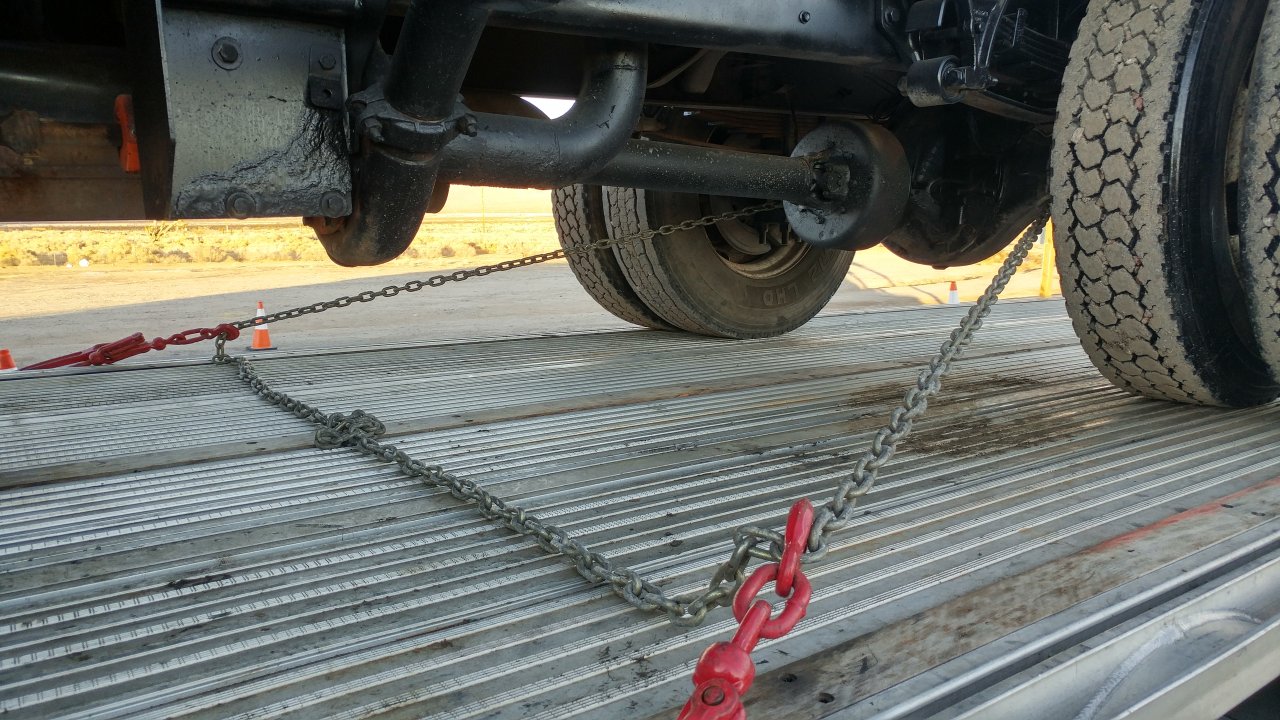

    You dont have to hook straight to the trailer. If you had hooked the binder to the chain on the othet side of the spill it would of worked. 1 chain 2 binders works, but there must be slack in the chain where it drapes over the trailer to the other side.
    It's difficult to explain in text. basically you are making your chain into two chains without physically cutting it in half. Maybe someone can post a picture.
    cke Thanks this.

    I should of read more of the thread before first replying. This picture shows what i meant, just instead of hooking right to the trailer i loop the chain around a spool.
    PoleCrusher, cke and TripleSix Thank this.
