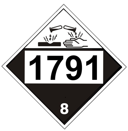

    These are what condo & I were talking about:

    A quick google search for "UN 2801 Placard" turns up these as acceptable to use. If you need to have the UN number on the placard, the blank (in which case you'd write in the UN number with a marker) or the 4-digit placard would be what you'd need to have. The placard your pic is showing looks similar to the "blank" placard....except the "C" and the "E" from the word "Corrosive" were not covered up. If that concerns you, take a black sharpie and black those letters out. Then, you'll have the "blank" placard with the UN number written in.
    In any case, the placard must identify the material in the trailer....and it does. MSDS was easy enough to come up with.

    Per 172.301(a)(3), if you have more than 8,820# of an HM item in non-bulk packages, and it is the only item on board, then you are required to display the ID# on all 4 sides of the trailer.
    To do this you have 3 options (172.332), put the ID number in: a white square on point device (placard sized), orange panels, or incorporated with the placard. If you are going to put the ID number on the placard you have to do it according to 172.332(c).
    Other than being a different ID number, it should look like this:[​IMG]
    If a truck came through my scale with the placard and ID number markings you showed in the picture, it would definitely get my attention.
    So, what would I do with the placards and markings you showed in the picture? First of all, I would have to give someone an "E" for effort. I have seen much worse attempts. It is legible, the right size, shape and color. Can I tell as a first responder what I would be dealing with? Sure.
    On a DOT inspection, if I wrote anything up at all, I would make a single entry warning for ID marking violation, reference 172.332. There is no placarding violation. Not out of service, not a citation.

    Big thanks scalemaster. So I can flip a placard on its backside and hand-write 2801 in black on a white square-on-point background? Would I include the "8" at the bottom? or place this white UN placard next to a general class 8 flip placard?
    Thanks again
  11. Autocar
    Autocar Road Train Member
    3,167
    2,358
    Apr 28, 2012
    The Hot Rod Shop Oxford, AL
    As Scalemaster said, it must comply with 172.332(C), that means that most people cannot handwrite it, as most people cannot reproduce the characters specified, by hand.
    Your white, square on point placard, with the number would be displayed beside the Class 8 flip placard. You would not put the "8" on the white placard.
