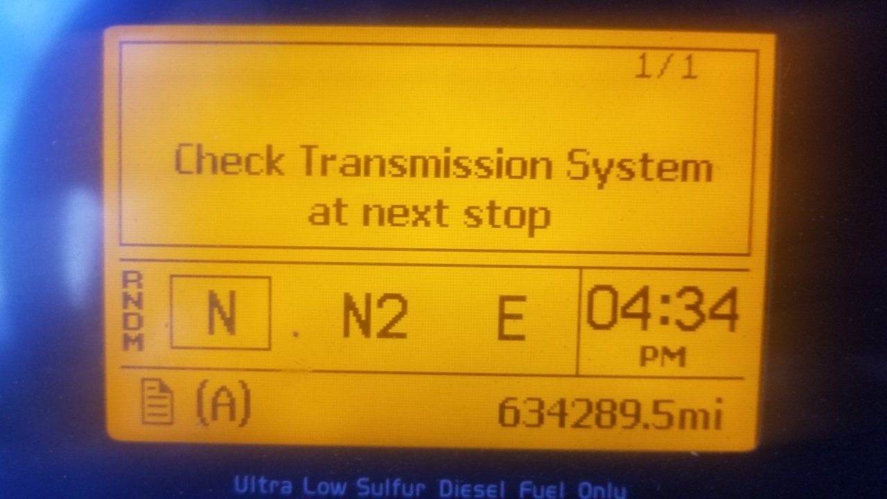

    Hello Again People -- > Truck - iShift - 2012 / 670 - D13
    Check engine fault just goes on then disappears. - Check Transmission at next stop **
    also image of Error Codes = MID 130 PSID 27 FMI 8
    * Click on Image to expand *
    There are no problems with shifting or anything.* Also there are not "noticeable" air leaks.

    If you google that code it actually pops up a few threads here. According to the first one I read it says Clutch control valve assembly on the side of the transmission may be contaminated.

    so this is a clutch systems fault, most of the time being set from low air pressure or air leaks, it could also be set if the cca is seeing a higher actuating position than what it has seen previosly, that being said most of the time they happen when air pressure is low, i would test your clutch system with ptt to make sure there is no leaks in the system and also check the X values and see what kind of condition the clutch is in being that the miles you have are at the point that i have seen a lot of these clutches go before. being that it did it only once i would not worry to much about it, #### like this happens all the time when there is sometime even quick shifts from r to d of pulling in a dock. If it occurs more times i would highly advise to change out clutch actuator, clutch and the valve that way you do it once and you never really have to worry about it again.

    NasRiza, Shogun - Correct .. I went to Volvo and had them put it on the computer
    and they confirmed the Clutch Actuator. needs to be replaced.
