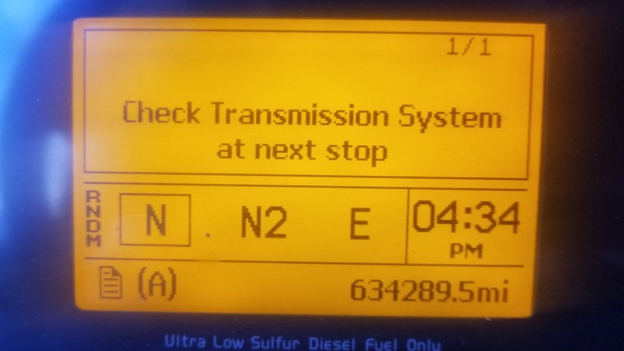

    Pls anyone have idea on check transmission system at nest stop or what I can do

    Pls what you do to your truck when is showing check transmission system at next stop

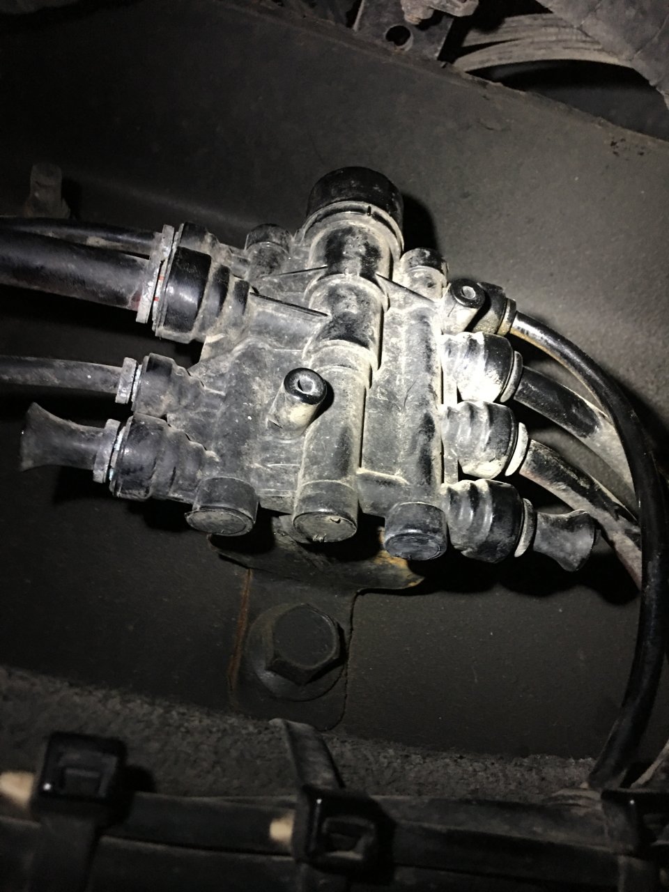

    i see there is air leaking in here,is there any idea what it is please?
  7. nasriza
    nasriza Road Train Member
    2,397
    2,070
    Feb 1, 2013
    Chicago, IL
    Called a safety manifold leak all the time replace it cheap about 70 $ and quick to do.

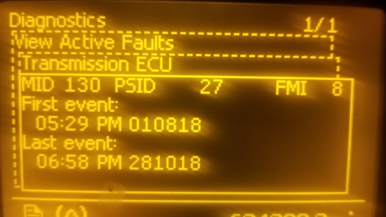

    Im having the same issue on a 2017 volvo 503.000 miles on it. Anmd im getting this code "SPN: 5747 FMI: 12 (Failure) Count: 1" anyone have an idea?
  9. Bath
    Bath Bobtail Member
    7
    4
    Dec 12, 2015
    I had the same code, whenever I used to hold my brake pedal for few seconds at a stop sign or light this annoying code would show up and go away doing the same after sometime, so, I changed the Brake pedal micro switch and it immediately solved my issue ( thanks to Alex D13).
