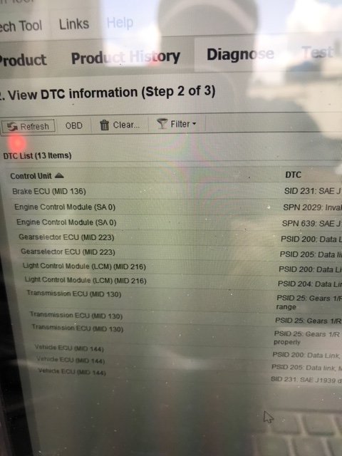

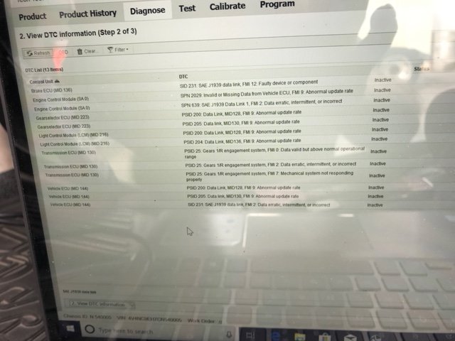

    I have uploaded a pic of codes. Mechanic says there are many possibilites and he has to take his time to thoroughly inspect this.

    Mid 130 PSID 25 Fmi 0 , Mid 130 PSID 25 FMI 2 are inactive but can you tell me what is the count number ?
    Is the transmission is grinding when going 6 Th to 7th ?

    PID 161 Input Shaft Rotation Speed.
    The counter shaft speed differs from both the main shaft speed and the vehicle speed received from VECU. You will need Volvo software for verifying what sensors are reading. Don’t you have an ishift warranty still???
