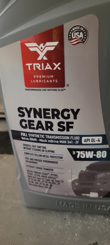

    put fluid in location 2 should be a brass 1 1/4 plug location 3 is sighglass. and yes thats the right fluid.

    Where did you get the fluid and how much?

    You sure about that? Manual says the opposite.

    Got the oil off amazon , 1 gallon was 38.60 with free prime delivery. they have 4 gallons for 129.00
