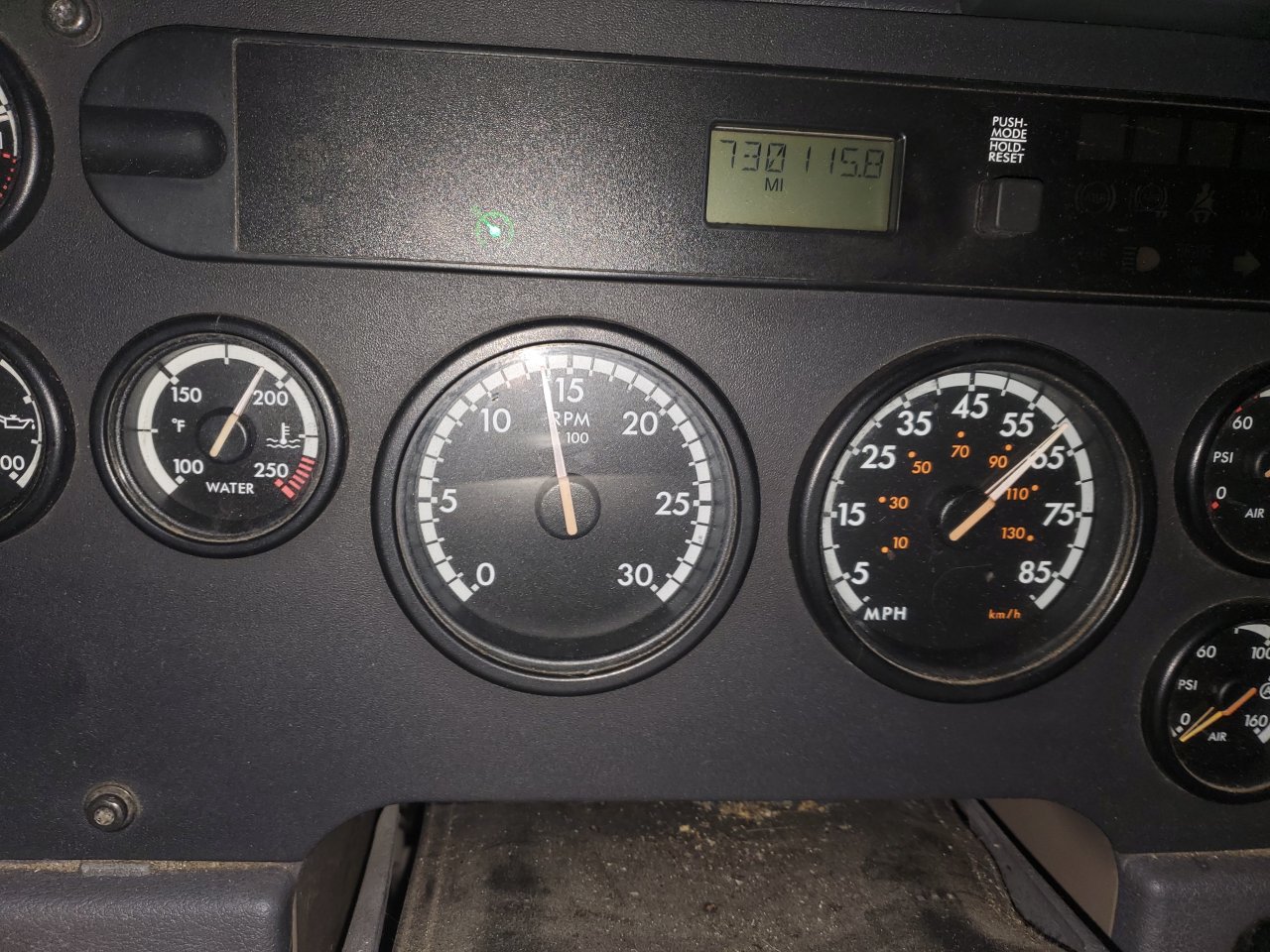

    I wouldn't overhaul it dave until the oil consumption gets high , mine was guzzling a gallon every 1000 when I had it overhauled and still ran good .
