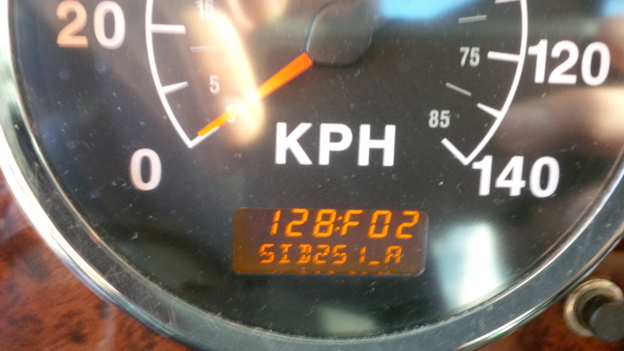

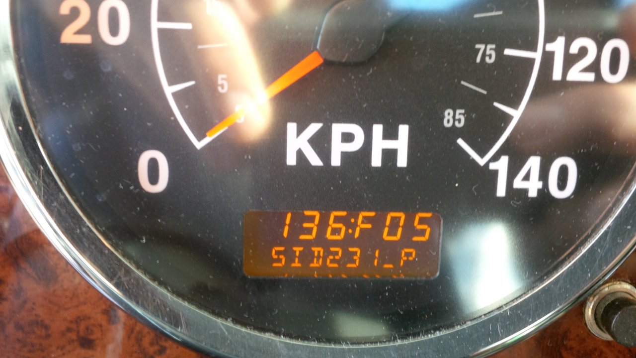

    I'll start off with saying I'm new to this site. After 17 years of being a driver on payroll, I've taken the plunge in becoming a Owner/Operator. I landed a contract with a busy freight company and feel very fortunate for being home every night.
    I purchased an Ex. Ryder lease 2007 International pre DPF truck with 280,000 miles. I didn't want any of that emissions junk on there, I'm aware of the issues. Turns out I got more than I bargained for. Upon my first week of working it, it started behaving oddly. I dismissed it as the truck may have been sitting for a while and needed to be driven.
    The issue is it will randomly, without rhyme or reason shut off momentarily. It did that the first day I drove it. The engine warn light came on and brought it to Ryder to have them look at it. They didn't find anything abnormal with the code reader. After that it drove great for 3 days. Yesterday, it started doing it again on the highway about 4 times in the span of 5 minutes. Instant loss of power like turning the key off for a second and flipping it back on again. Today it happened about 10 times. It occurs at any speed or time, highway or backing up, idling. Smooth or bumpy roads. I will leave it in gear and coast until it fires back up on its own.
    When it occurs while idling, it cuts out and back in quick enough that the engine won't stall out, it'll just quit for a split second and fire up again. On the highway, I leave it in gear and it fires back up. Hit resume on the cruise like nothing happened.
    What I observed in the moments it was off but coasting at highway speeds:
    - All gauges are functional except the speedo needle drops
    - Voltage doesn't drop while coasting
    - No signs of missing, erratic running at hwy speed or idling
    - Engine Warn lamp lights up and shows faults according to the LCD odometer readout. If truck is shut off and restarted, all faults are cleared and Warn lamp is out until it trips again. Codes are pictured below.
    I'm sorry for the long post, I'm giving every detail I know about the issue since Ryder either knows the issue and are refusing to fix it or they're simply unable to fix it. They will not give me clear explanation on the code readout.
    I'm my 1st week in with 500 miles on the truck and already facing what feels like a major problem.
