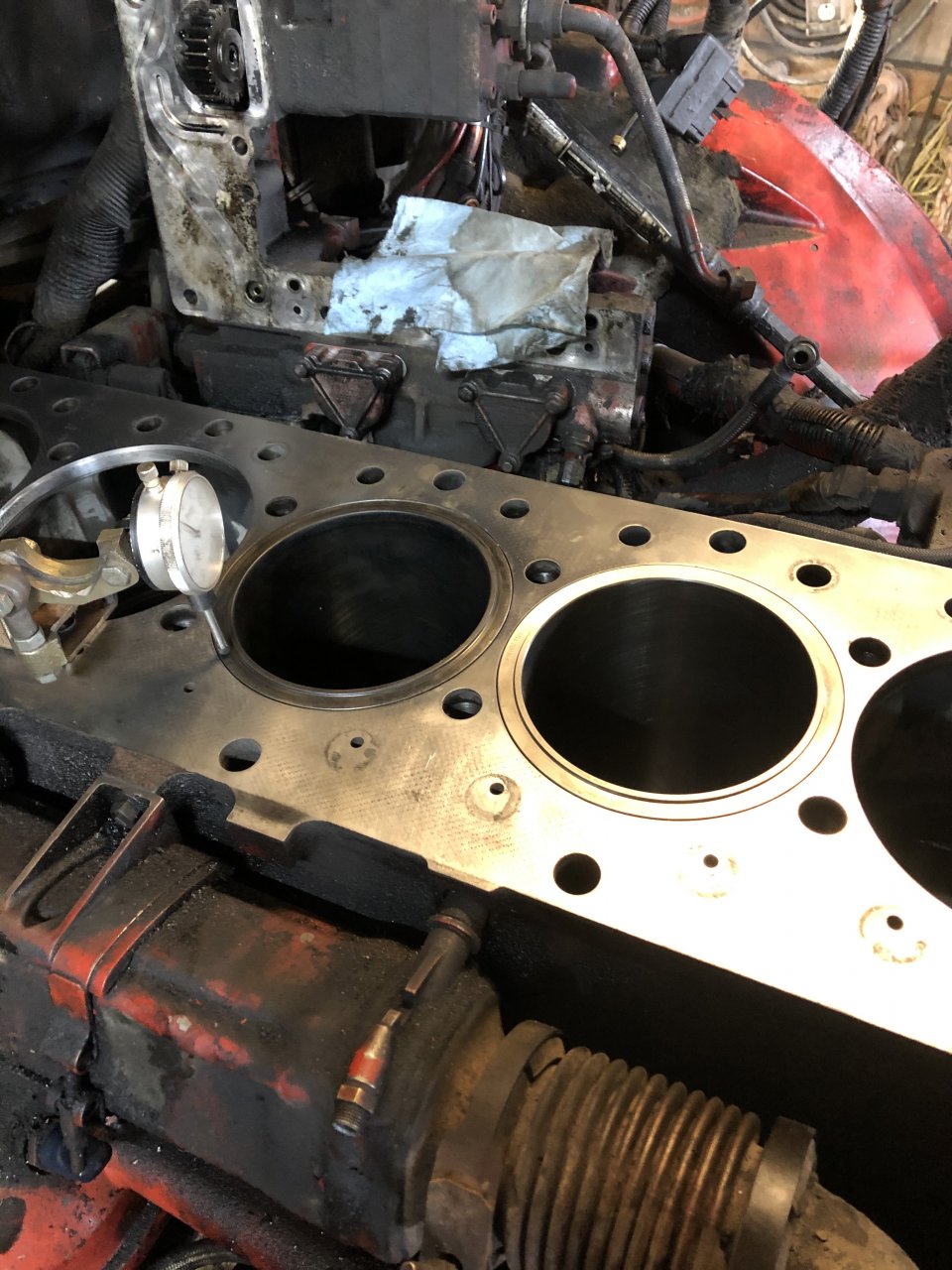

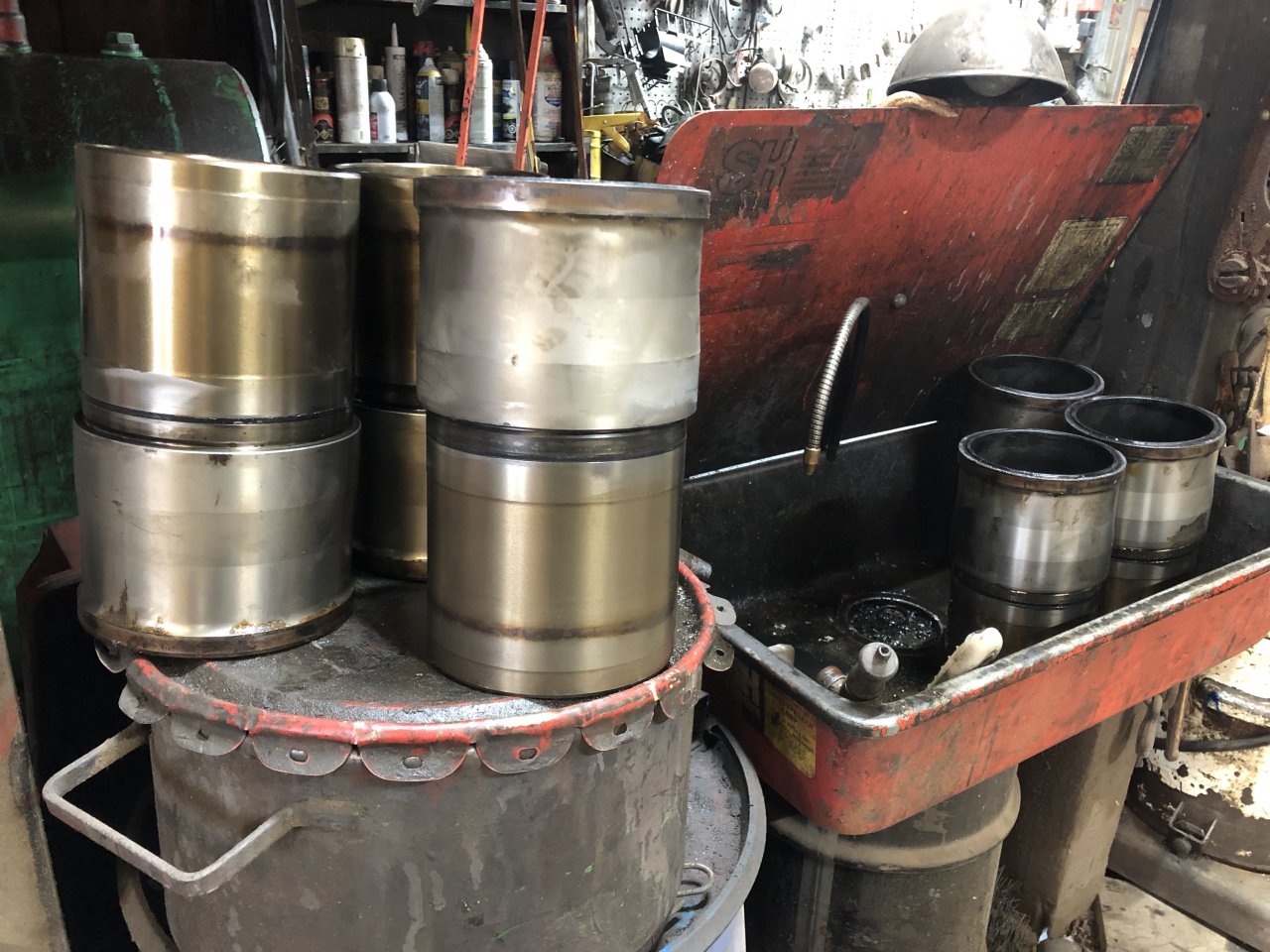

    I’ve got a 2005 ISX all apart at the moment.
    The sleeves look really good with no pitting.
    They have no shims.
    Counter bores also look really good.
    My boss ordered a PAI rebuild kit.
    I see the new liners came with brass shims installed.
    Picture here I’m doing measurements with both old no shim sleeve and new sleeve with brass shim.
    Both came within .012” protrusion.
    Told my boss that we should get the old sleeves re-honed and reinstall them ;)

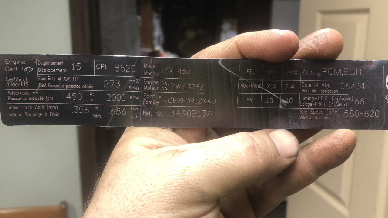

    Pretty sure you should be measuring protrusion with the liner clamped? ESN?
    If there’s no fretting and the block looks good what’s wrong with rebuilding with stock parts?

    I did have them clamped, I posted the wrong picture.
    I have two pictures, one with the bolts and the other without.
    My boss thought the PAI kit would be a good upgrade kit from research that he’s been doing.

    .012 is great. I have always had good luck with PAI kits. They come with everything you need.

  8. Truck engine machinist
    Truck engine machinist Light Load Member
    195
    188
    Dec 2, 2011
    USA
    Do not use the brass shims. They smash with time. Use only stainless steel shims. I have some that will get the liner up to the high side of the spec. No machining necessary. Call me 7173688532.

    You should be clamping them, with the Cummins crossbar tool, and the clamp down screw torqued to 100 ft. lbs. The liners usually push down, .001"-.0015", when you do that. Most mechanics, that I work with, try to run them at .014" to .015".
