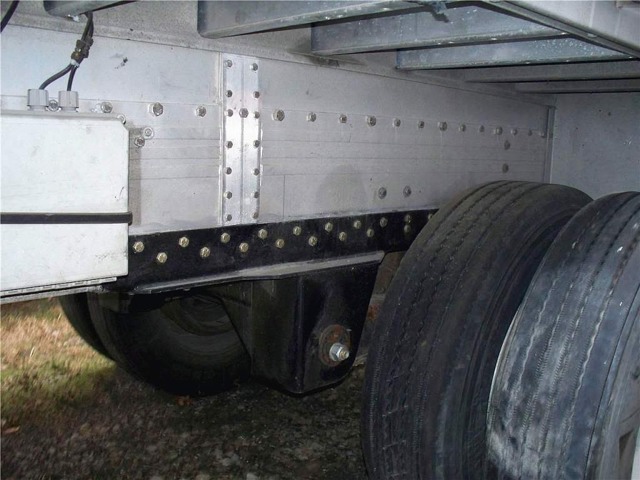

    Run, don't walk, run away from a Reitnouer! Especially if its a 2005-2007 model. Around here they're giving Transcrack a run for their money for breaking.

    Will still add my comment! On my second Reitnouer (last one an '03) and had no problems, both have had forlkift kits; will have another when I get better off $-wise.

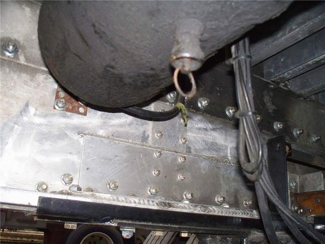

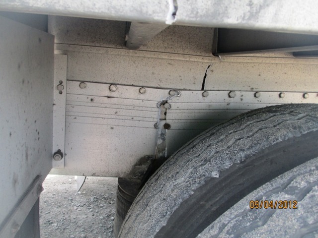

    Don't put a big load on them and they do fine. If you notice they have changed how they mount the axles. They would crack where the air line would go through the bottom flange of the frame. New ones have the air lines on the outside of the frames.
    Been 3 here locally that ended up like this one.

  8. SHC
    SHC Spoiled Rotten Brat O/O
    8,484
    7,047
    Feb 26, 2011
    Westville, IN
    OUCH!!!!!!
    that would make me rethink buying one for sure !!!
  9. tardhntr
    tardhntr Bobtail Member
    14
    9
    Oct 16, 2012
    Here's another that they "patched"

  10. tardhntr
