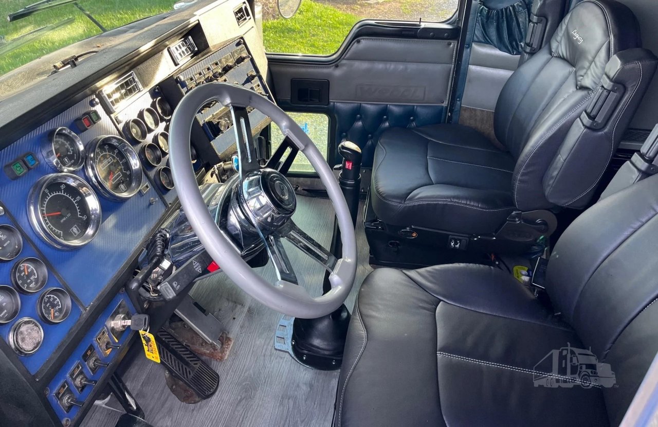

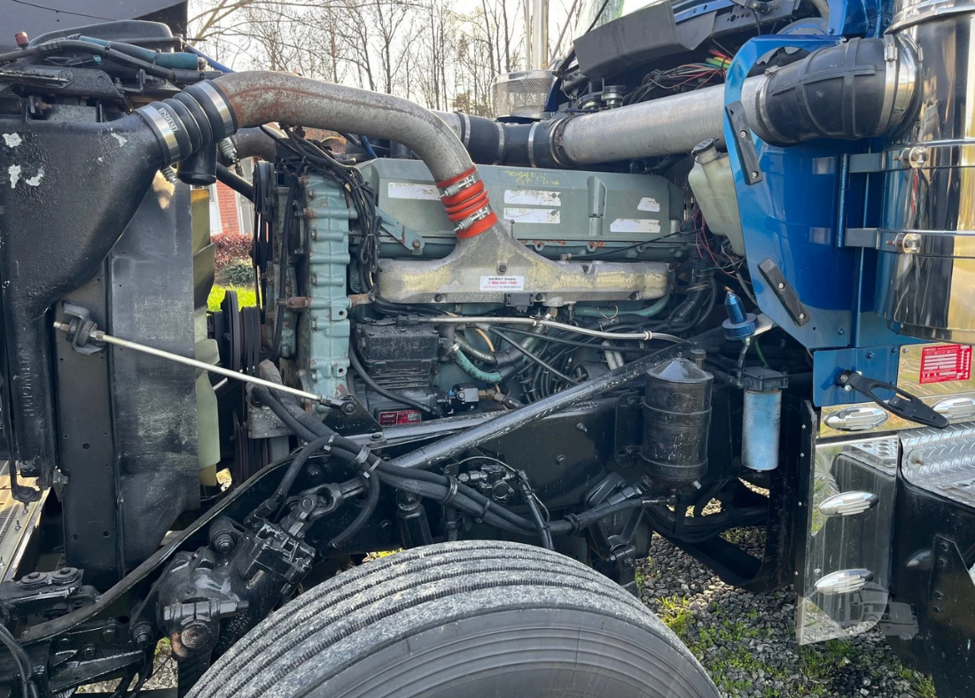

    These couple pics, and they're not much. All the rust around the pedals, turbo boot doesn't look quite right, alternator belts not quite right, and missing 1 fan belt.
    What is the new frame paint hiding? Love that fancy dash and floor, usually a sign of somebody who favors looks over functionality. Same guy who has lots of chrome with bald tires
    CAC looks original. Sure it's good 25 years old?
    You post more pics I'll find more problems

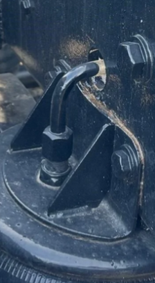

    Bit of rust jacking going on there around the air bags. Probably the same around the fifth wheel slide, crossmembers, etc. How many air bags and pass throughs will it need?

    New Michelin steers on her?
    that truck probably would of been 100+ with a yellow motor
    looks like an ag400 conversion too with new upper bushings
