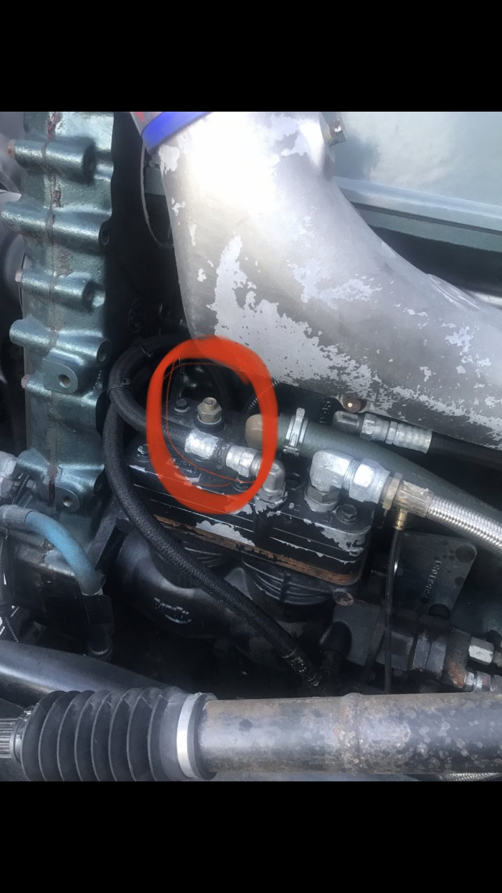

    Ive got a Bendix air compressor on a Detroit 12.7. All the videos I watch tell me to look for 3 screws on top of the compressor for the unloader valve..... Im not seeing it? Is the unloader valve this....pic coming up....
    And to replace it is it just a screw off screw on kinda deal? I assume after letting all the air out of the system first.....

  4. 062
    062 Road Train Member
    6,338
    33,982
    Oct 20, 2013
    That’s the pop off valve. It’s to keep the pressure from getting to high.
    Unloader is to put air in tanks.
    What problem are you having?

  8. Hulld
    Hulld Road Train Member
    2,884
    6,568
    Oct 19, 2015
    Upstate NY
    the two oval plates held in with two screws a piece is where you will find the unloaded valves
  9. Hulld
    2,884
    6,568
    Oct 19, 2015
    Upstate NY
    From your picture it looks like they could be hidden under the hoses...
    nikmirbre Thanks this.
  10. DougA
    DougA Road Train Member
    1,429
    8,892
    Dec 16, 2013
    Retired,In my shop in Md.
    Unloader valve or valves,depending on compressor are in the compressor head. They are spring loaded valves,that open and close on signal from the air governor. When compressed air isn't needed they open and the compressor does not build pressure.
