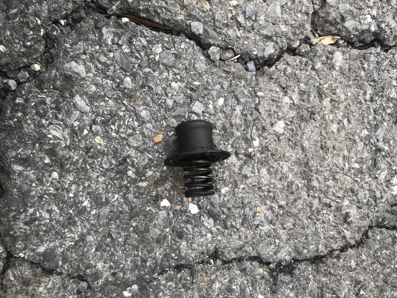

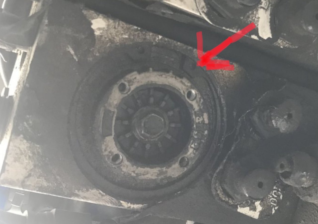

    Ok 1st 2 pics is before I touched anything.
    3rd is after removing the spring being held by those 4 bolts.
    Last picture is new purge valve....
    does that bolt in the middle come off? It seems to just turn and turn

    In answer to my question in post number 24, it looks like that black top of the dryer needs to come off in order for that bolt on the bottom to be removed?

    You have to pull the snap ring out to allow the valve to come out.
